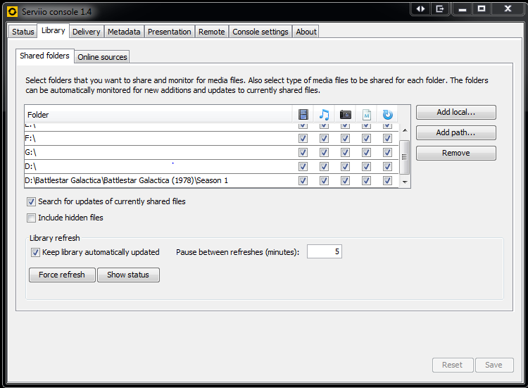

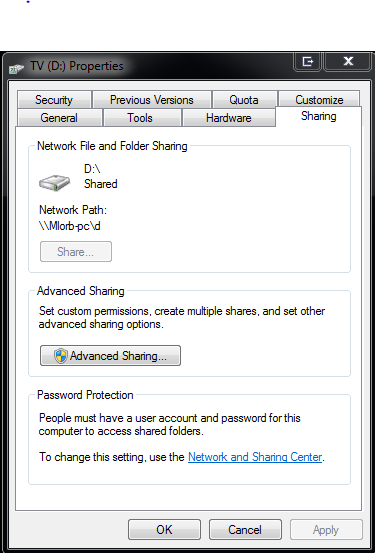

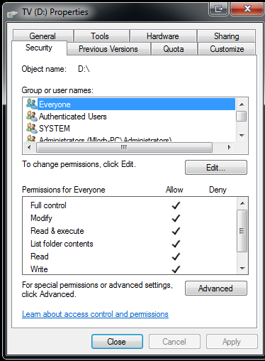

Hi i have a Samsung Smart TV UN75F6300AF, Serviio version 1.4, Java 7 standard edtion. I have been trying to get this to work for weeks now, trying all sorts of things and even other programs, but this one seems to work the best so far. I will try to give as much info as possible, so i don't get advice on the stuff i have already read on these forums and tried. I have shared folders D, E, F, G, added them to my libary and they are all updated. I am able to access all the files and folders on those drives , i just can't seem to access any of there subfolders. Drives F and G just have video files in them with no folders, have no problem playing any of the 2000 movies on them. In D i have all my tv shows i can accces them if they are in the D drive itself but if they are in a folder of any type Example D:\TV\Battlestar Galactica\Battlestar Galactica (1978)\Season 1, i can see the Battlestar Galactica folder, but when i go to enter that folder on TV it says "Request cannot be completed. MEDIA PLAY will be return to the main screen". Now the D folder is shared i even tried to share the Battlestar Galactica folder and all the folders leading to the video i want to play, in windows and in serviio, but still no luck. When i try the to access the season 1 folder directly the TV says "No video files found on the coneected device.".
Any ideas plz help.
I don't think it is a sharing issue though, it may be a Samsung issue cause i can access most but not all the folders threw Videos/Series on the TV but not threw Videos/Folders/D. When i access threw the series folder though the id tags (Metadata) are all named retarded, so i would like to be able to access them threw the way i have laidout on my pc in order and named properly. Also i can only access the 1978 Battlestar Galactica, i don't see the 1980 season 2 or the 2004 BSG.

i have no windows pc in front of me right now, so i can't tell you exactly by pictures BUT you have to be sure to give full permisions for:
1. give everyone permisions for share
2. give everyone permisions for folder and files
then you are sure your windoze won't block you
