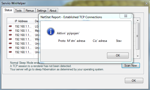

    Doesn’t work for me. When I click NetStat it shows strange things.
    Running on Win7 SP1 32b Czech version (may be localization is the problem?)

    @hans - yes it's localization. Also need to think on this....

    Is this the file extension or container support ?
    DenyAll wrote:...What other one's do you think should be included?...
    We know that serviio "matcher" supports all these containers (file extension is not analyzed) :
    container - compulsory; name of container; possible values: * (any), asf (WMV), mpeg (MPEG2PS), mpegts (MPEG2TS), mp4 (MPEG4, MOV), mpegvideo (MPEG1), matroska (MKV), avi, flv, wtv, ogg, 3gp, rtp, rtsp, applehttp, rm (RealMedia)
    So you could probably add : asf,mpeg,mpegts,flv,ogg...
    Post Wed Nov 20, 2013 11:20 am
    Re: Serviio WinHelper (Sleep Management and Tools for Window
    It's done on file extension. I'll add your suggestions.
    Cheers
