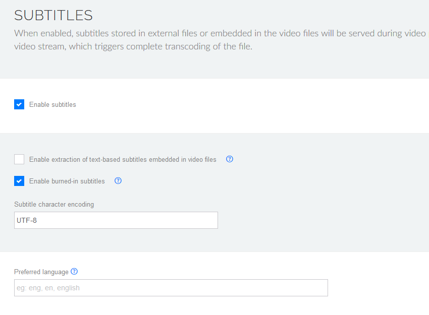

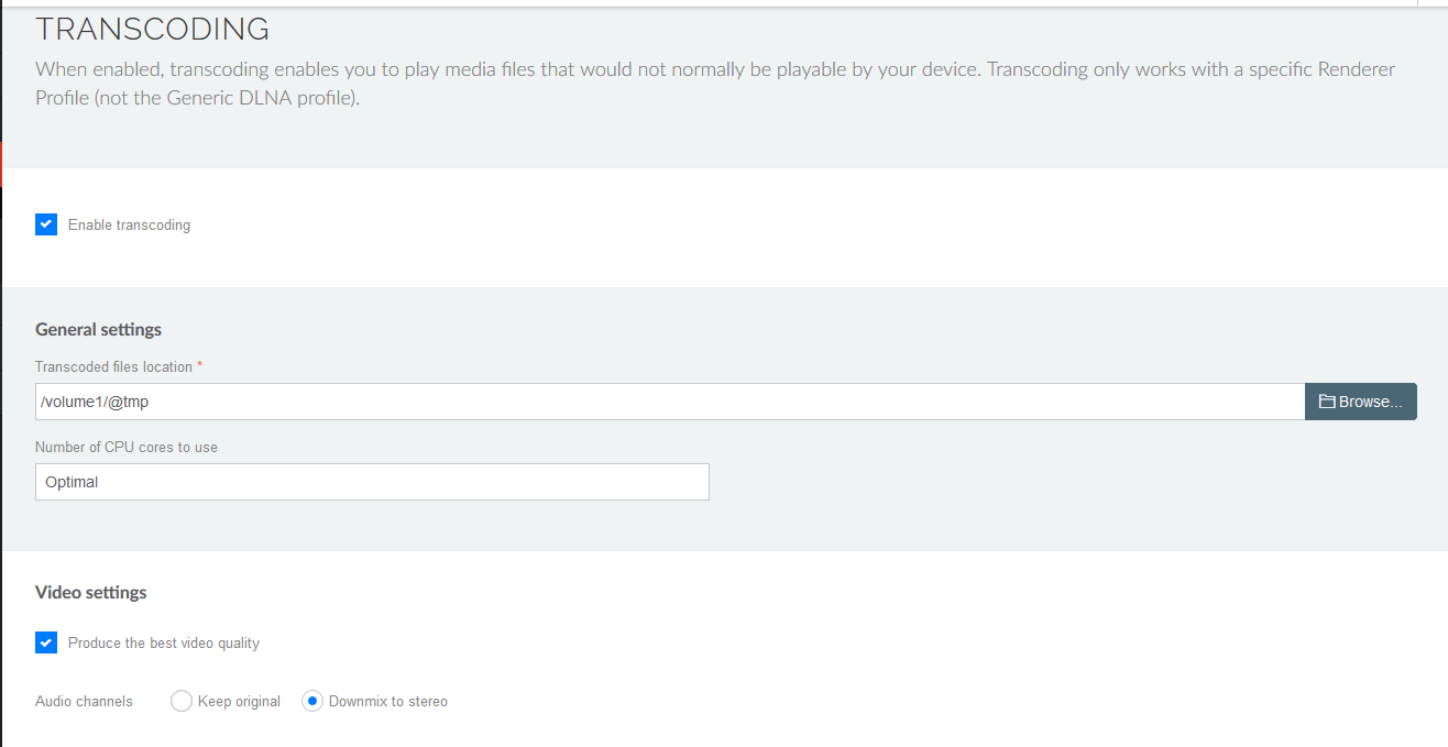

somu
Joined: Wed Apr 27, 2016 7:22 am
Post Fri Apr 29, 2016 6:46 am
Re: DTS Converting to AC3; then movie stutters
hey,
you've screen in attachments.
most of codec from movie are DTS and AC3 for MKV
and only DTS doesn't have any sound without .xml modification
Audio Info
Subtitles
Transcode
