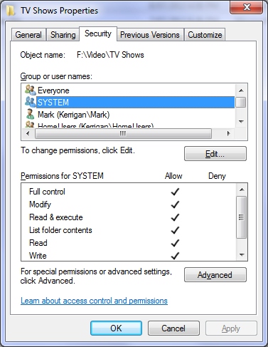

Assuming your PVR uses an NTFS drive, then it have a security framework applied. To edit this: right click on the PVR's drive in Windows and select Properties, then Security. Press Edit, then Add. Type in System and press Check Names. Press OK. Then assign full control (bottom bit) and press Apply.
From memory you'll get a prompt asking to do it for this folder only; or all folders, subfolders and files. Choose all folders, subfolders and files. This should be all you need to do to give Serviio access, however if you need to go further you can also do this for Everyone group (the Everyone group is all users, system, network users... basically everyone). Follow the same instructions as above but type in Everyone in lieu of System.
If you do it correctly you should see something like:
The reason you can see it from your PC is that you log in as your user name, which you will see in the security tab as being allowed access. Serviio logs on as the System user... you need to allow this "user" access as well.

If i access any of the remote folders anywhere on our local network from my pc and click on Properties like you suggest, I do not see what you describe.
For example on the pvr hdd I only see two tabs (General and Customize)
Of these, General tells me how full it is plus its attributes and Customize lets me select the type of content is can contain and what picture to apply to the icon.

On the General tab, what file system does it show?
I have shown what you get in Windows 7. Security under XP was a little different, and I can't remember how to get there, but try this article: http://compnetworking.about.com/od/wind ... pfiles.htm.
