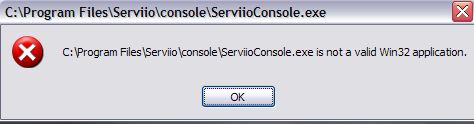

Thanks. I'll try it as soon as i get 1.5.2 re-installed. 1.6.1 isn't a valid w32 application.

Post Fri Apr 08, 2016 11:20 pm
Re: Tune In radio
fidmas wrote:Thanks. I'll try it as soon as i get 1.5.2 re-installed. 1.6.1 isn't a valid w32 application
This doesn't stop you using 1.6.1. See http://www.serviio.org/component/conten ... ?id=21#q20 last paragraph.

Re: Tune In radio
Yeah, except i just found out the console isn't 32bit compatible. I'll play more tomorrow.
