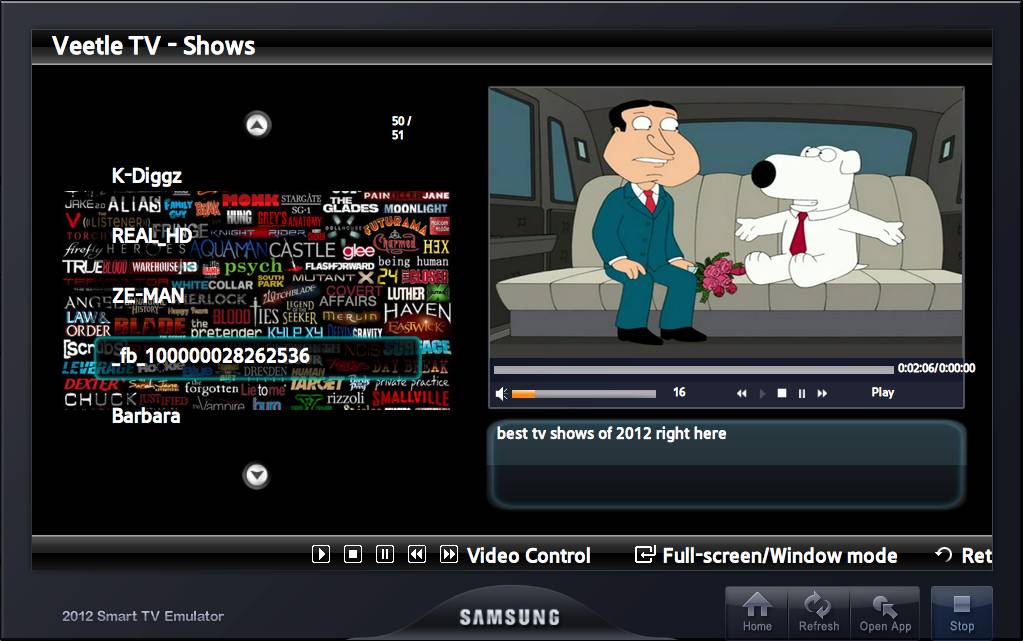

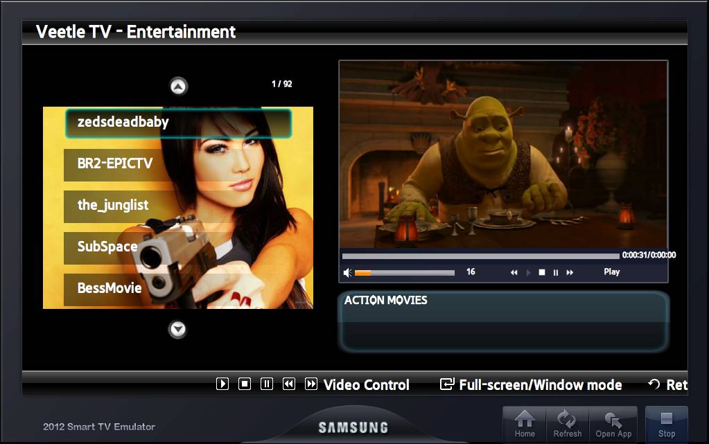

for those that have samsung TV , bluray player with internet@TV , I wrote during the weekend a TV widget for veetle ...
so now I get all veetle channels inside my TV app .. so the TV is now decoding veetle streams instead of the need of serviio + my plugin ...
so now I don't need my computer to be on to watch veetle

.... about samsung users .... look at this screenshots :) ....
my samsung TV / bluray app , waiting for samsung approval ..
