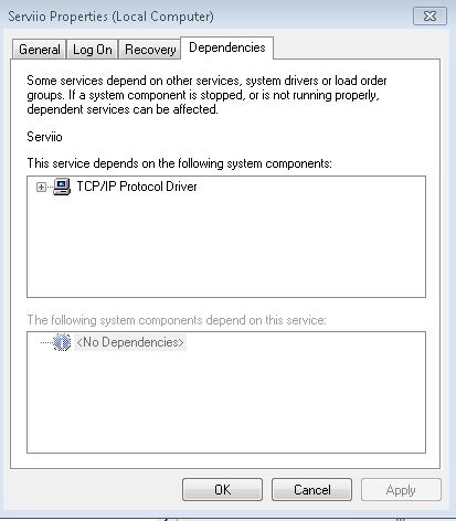

kubbaz - Here is what you could do in windows environment. Add 'Tcpip' and/or 'NetBT' services as dependencies to serviio service. This does require you to change registry which could potentially cause problem if you are not careful. However, if setup correctly, this approach is a fail safe method than that of delay start. Setting up a Tcpip dependency on serviio service tells windows not to start serviio until Tcpip (or NetBT = NetBios over TCPIP) is ready.
Procedure to add dependency:
1. Start regedit
2. Go to - HKEY_LOCAL_MACHINE\SYSTEM\CurrentControlSet\Services\Serviio
3. Then click Add Value
4. Create a new value name "DependOnService" (without the quotation marks) with a data type of REG_MULTI_SZ, and then click OK.
5. When the Data dialog box appears, type Tcpip (case sensitive, one entry for each line if you are adding multiple dependencies), and then click OK.
If the everything entered correctly, your serviio service dependency should look like attached picture.
Note: I also have .reg file with encoded dependonservice key with this post. The .reg file only applies to windows 7 64bit.
WARNING !!! DO NOT APPLY .REG FILE DIRECTLY TO YOUR PC. THE FILE IS FOR YOUR REFERENCE ONLY.
Serviio-Dependency.reg.txt
(350 Bytes) Downloaded 1241 times

npuser wrote:kubbaz - Here is what you could do in windows environment. Add 'Tcpip' and/or 'NetBT' services as dependencies to serviio service. This does require you to change registry which could potentially cause problem if you are not careful. However, if setup correctly, this approach is a fail safe method than that of delay start. Setting up a Tcpip dependency on serviio service tells windows not to start serviio until Tcpip (or NetBT = NetBios over TCPIP) is ready.
1. Start regedit
I cant imagine im the only one with this issue, it seems too simple.
i think the above info should be stickied, and maybe elevated to have this reg edit incorporated in the next version. It certainly done the job for me anyway
As far as the results have gone, so far, flawless. I have restarted several times and has worked every time
