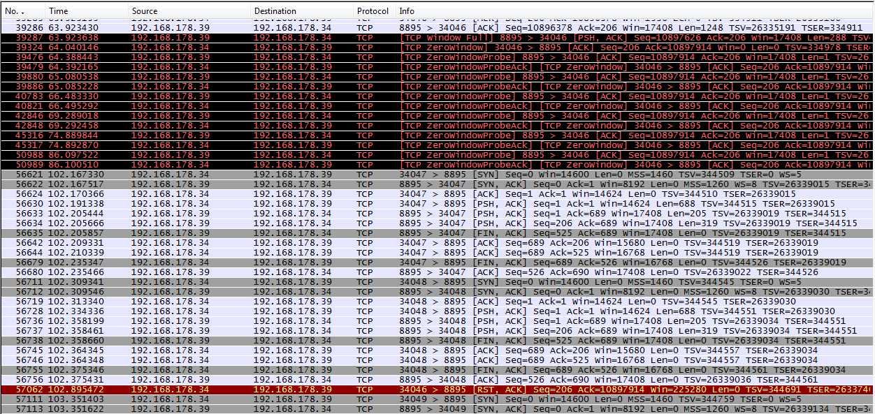

Streaming a Sopcast channel to a Samsung TV F-Series is working fine but interrupted after a couple of minutes.
From a packet trace it seems the issue starts when the TV sends a TCP Zero Window packet with length 0. I assume the TV does not understand the Zero Window Probe ACK, performs retries and a Reset is sent out 60 seconds later, then the port is closed and the connection dropped.
The trace is big and cannot be attached to this topic, see attached a screenshot.

See comments in my SOPCAST plugin thread about Samsung dropouts.
viewtopic.php?f=20&t=7249&start=60#p63628
viewtopic.php?f=20&t=7249&start=80#p65166
