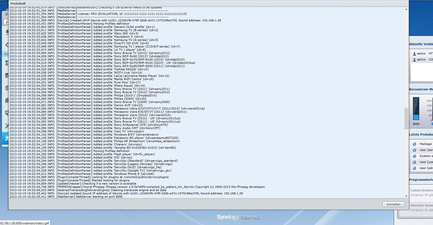

Post Sat Oct 19, 2013 5:20 pm
What does the serviio.log file show?
Sent from my DROID RAZR using Tapatalk
kylian2003
Joined: Sat Oct 19, 2013 1:39 pm
Post Sat Oct 19, 2013 6:46 pm
Re: Samsung SMT-G7400 Horizon Box profile
Hi
you can see it in the attachment.
and here is the code i add
