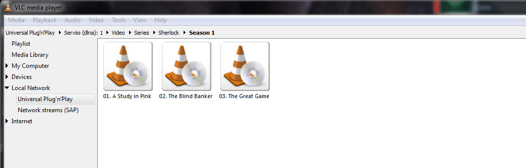

I thought that it might be the server so I tried it in VLC on my laptop so it is working.
When you say "tried it in VLC on my laptop", do you try with the VLC DLNA feature ?

Yes I went to Local Area Network and chose UPnP and navigated from there.
I have the screenshot attached.
