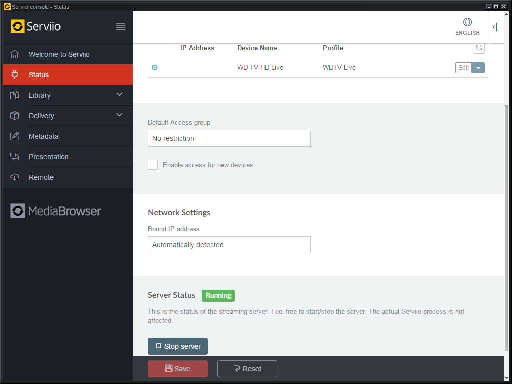

I just install Serviio and run, and server find my device automatically. Why I need password? Because when I start server I can connect to Console with public IP...
Type in browser http://pIP:23423/console/ and you are in... you can now shutdown server or delete Library or... :shock:
Serviio Status Screenshot

For the console password issue: Serviio does not open port 23423 in your router, and this is the only way access could be gained from the internet. Have you done this manually (manually forwarded the port, or enabled DMZ operation in your router??). Otherwise is something else triggering UPNP port forwarding (usually you can also see this in your router).

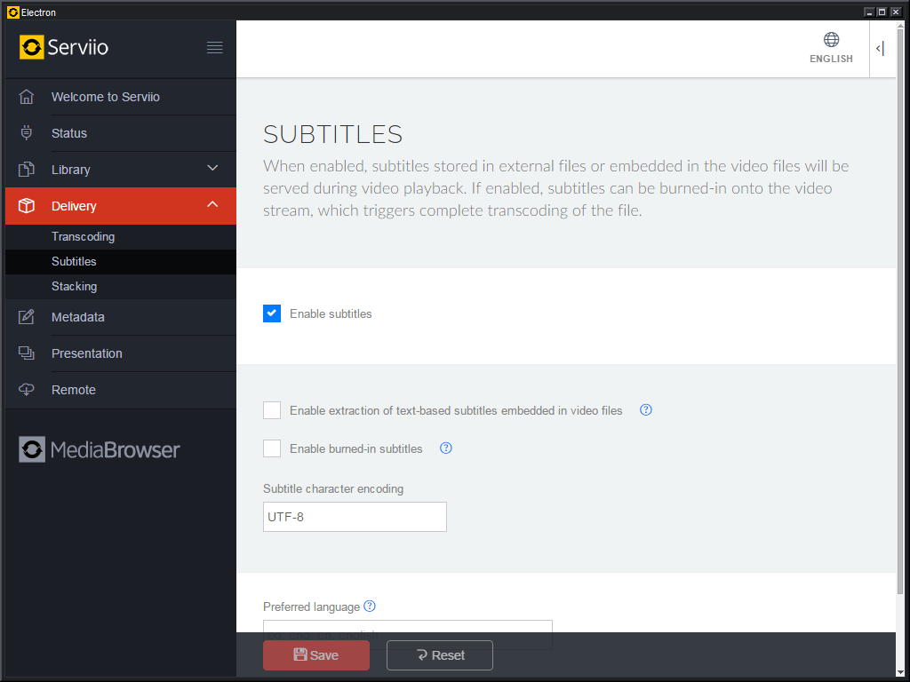

I try add subtitles with "OPTIONS" on WDTV remote controller but no subtitles there. (works only when enabled burned-in subtitles)
Here is configuration and log for Serviio.
Serviio Debug Log File
(139.76 KiB) Downloaded 1189 times
Serviio Subtitles Screenshot

Well that would be the problem. You need to then bar this in your firewall (either windows firewall or if you are connected via a dedicated firewall, that device). You can either bar port 23423 from any incoming access, or allow it only for selected IP ranges (eg. allow it for your internal LAN addresses, and bar all others).
Most people would work via a router that would block this access by default, so your original request for a password isn't required for them.

Serviio is playing your media file (Hail, Caesar! 2016.mp4) natively however does not find/serve an associated sub-title file for this media file.
What is the name of the sub title file (including file type) for this media?
Have you tried refreshing your library manually (using the Refresh button in Serviio Console)?
Ok I do it with firewall.
Subtitles named like video file there is no all logs...
Hail, Caesar! 2016.srt

Hmmm - reached the end of my knowledge. It should work, but Serviio doesn't appear to associated the srt file with the media.
Perhaps try (long shots):
  • renaming both files removing the punctuation marks (do the srt file first, then the mp4) eg. call them both "Hail";
  • embedding the subtitle into the mp4 (not an ideal solution, may assist in the ultimate solution). Plenty of tools around to do this, but with ffmpeg you use the command
    ffmpeg -i "Hail, Caesar! 2016.mp4" -f srt -i "Hail, Caesar! 2016.srt" -codec copy -c:s mov_text outfile.mp4
    and see if the outfile.mp4 plays with subs

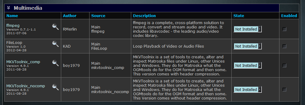

Can someone please tell me if install some of these tools, whether it worked or not?
ffmpeg - use the version that comes with Serviio.
FileLoop - don't know, but cannot see how it would be used with Serviio. In the DLNA world, looping playback is up to your device (your WD Live)
MKVToolNix - is a tool I use outside of Serviio to fix media file issues. Don't use these versions - download the latest from the web (9.2.0 as at today). I use it occasionally to do things like change the order of audio tracks and to mux in subtitles to files (as you are found). This tool (and others such as ffmpeg and XMedia Recode which I also probably more extensively than MKVToolNix) is useful for manipulating media files outside of Serviio.
