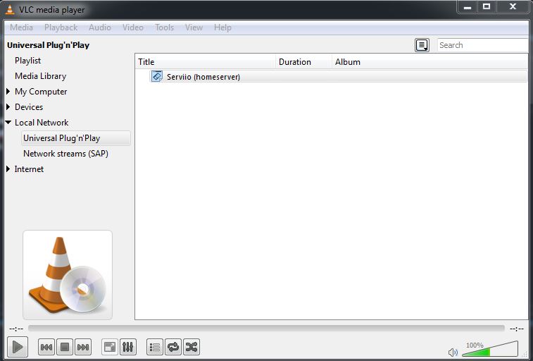

I am running Serviio 1.2.1 on my WHS 2k3, and everything is running well on my Samsung TV.
However, no computers on my network are able to connect using VLC.
I am able to see Serviio in VLC, but no media. It's the same on many computers (all running win7).
Any suggestions?

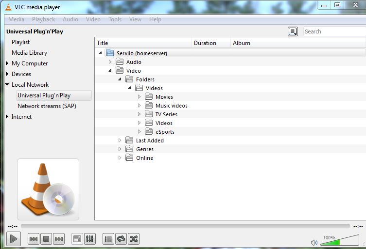

If i double click on the serviio list then leave VLC open for about 5 mins it then pulls in the list.
Its as if VLC is pre-caching the list of file from serviio before displaying them.
As of yet ive not found a way to speed this up.

Yep, VLC queries Serviio for its entire catalogue (you can see it if you turn on detailed logging), which is a pretty stupid implementation, don't think there is anything you can do about it.
XBMC works well with Serviio, although not as light weight.

Waiting a few minutes did the trick. (Gbit, massive media collection and a powerful server still took some time)
