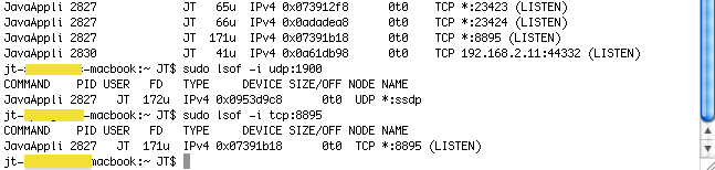

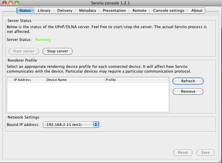

I just flat out can't get serviio working at all. Not with my Samsung D6000 smart TV (wired), and not with my 360 (also wired).
I'm on a MBP (10.6.8), and though I can ping the TV and Xbox, serviio is....not doing a thing. I have zero options for renderer profiles available. What I do have is an engineering degree and a lot of computer experience, but this type of communication is completely beyond my current level.
Partially, I'd love some practical advice for how to get the thing to work. Attached are pics of me (attempting) to verify the ports are open, and that the TV was being pinged. Also that the console offered no profiles for me to select, meaning I basically spent a few hours trying to figure out what I was missing. Bad design there.

Hi JT,
I am far from an expert but I have had good success with Serviio on home networks.
Question, After install of Serviio did you reboot your entire network ?
I have had problems with devices not seen (as I see in your screen shot) due to switches or routers picking up outdated caches of addresses that do not include new apps or firmware updates.
Also, do you have manual addresses in effect or is a device(s) serving automatic as DHCP host ?
Are all devices on the same subnet 255.255.255.???.
Sometimes just 1 device with the odd setting can cause big headaches.
