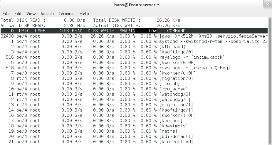

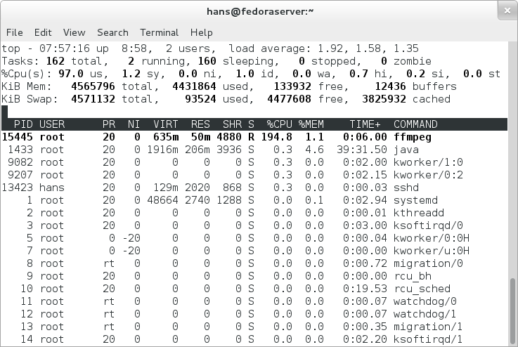

I marked it as solved, and will be updating the post a.s.a.p with full instructions/fix as I did it, but first I want to sort out the IO and CPU load. I attached the screenshots of the problem.
Any thought by anyone running Serviio on linux?
Please note the system I am using is as follows:
HP Proliant Microserver N36L
5 gig DDR3 1333Mhz RAM
160Gig installation disk
Data disks.
When this was running Windows 7, I saw a bit of CPU load, but not NEARLY as high as this, and the lights at the front of the machine was not going as ballistic as it is now because of the IO issues. So why on Fedora is this such a big problem?
IO issue
ffmpeg CPU load

It seems the disk IO and the high ffmpeg CPU load is due to the creation of thumbnails or retrieving of metadata for all my files. When I get home I will untick those settings, and see if it stops.
I found this info via:
ps -auxwww
and got output (edit for forum purposes)
root 9952 93.0 0.3 628372 17892 ? Rl 09:02 0:00 ffmpeg -ss 120 -i /mnt/2d73fb9d-be79-45f3-8781-d720f0f6ea07/blah/blah/blah.avi -an -frames:v 1 -f image2 pipe:
So I will see tonight when I get home how this is going.
Can anyone maybe confirm that this is the issue?
