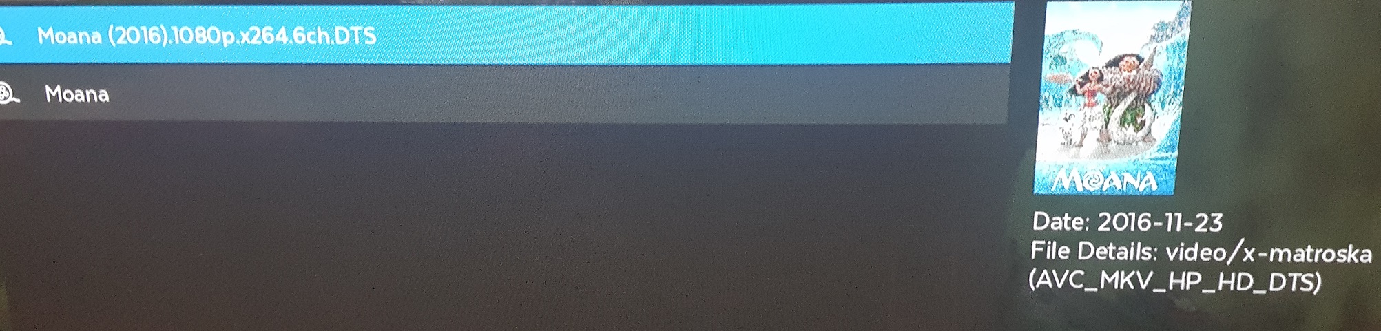

This is FetchTV with Generic DLNA profile, fetch reads the container, video and audio as AVC_MKV_HP_HD_DTS and serviio services it fine, video plays, but no audio. Understandable since no DTS support on fetch.

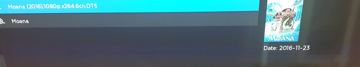

I change the FetchTV to my created profile, file still there but it no longer reads the container/video/audio and when i click it fails

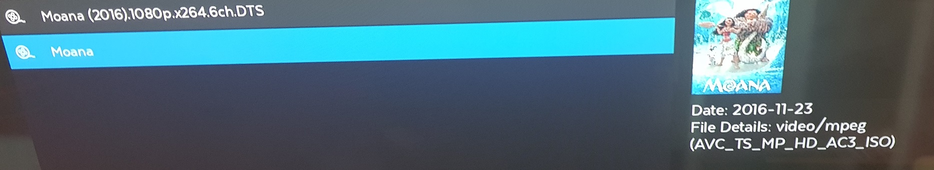

I changed my PC to use the FetchTV profile, opened the video, serviio correctly transcoded i copied the transcode string and created moana.ts with ac3 audio
ffmpeg fflags +genpts -threads 0 -i Moana (2016).1080p.x264.6ch.DTS.mkv -y -threads 0 -c:v copy -bsf:v h264_mp4toannexb -c:a:0 ac3 -b:a:0 192k -ac:a:0 2 -map 0:0 -map 0:1 -sn -f mpegts moana.ts
When i reference this file on fetchTV it reads it as AVC_TS_MP_HD_AC3_ISO
This plays successfully with video and audio.
