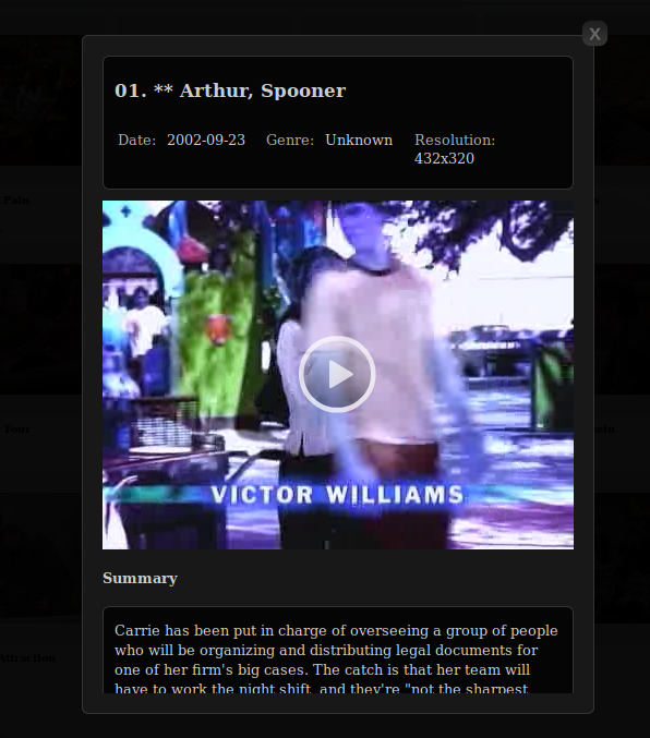

Now, that my Serviio Server is not Crashing any more, i found a other Problem.
When i tr to watch Films over the WEB Client, the movie is badly colored.. everithing is kind of Blue...
in the Log i find this Message:
2012-08-21 05:48:16,504 WARN [ProcessExecutor] Process ffmpeg has a return code
of 137! This is a possible error.
on other DLNA Client's this does not happen.
any Ideas :?:

Attached you can find a Screenshot, to see, that the FIlm looks "blue" :geek:
Regards
Sbec

the call would be further up in the log. regarding blue color - weird. Maybe a new ffmpeg would fix it?

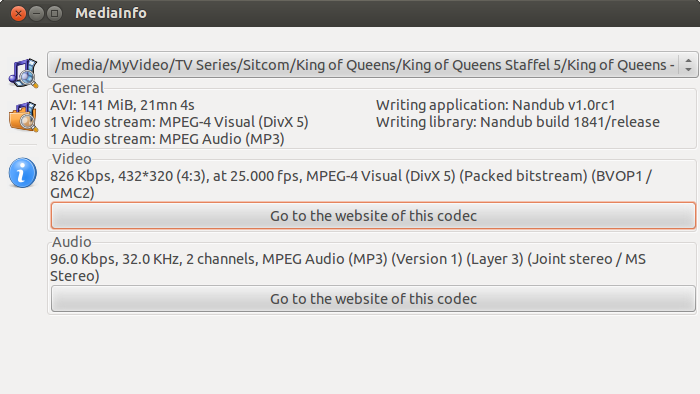

I just realized, thet this Film doesn't Play on my Samsung TV :-(
(Format not supported)
but if i Play it on a Video Player on the PC, it looks fine.
Attached you can Find a Screenshot of (Linux) MediaInfo

the ffmpeg command ( well, i had to set \ in front of Blanks in the File Name...) brought back
[mpeg4 @ 0xa34a8c0] Invalid and inefficient vfw-avi packed B frames detected
Input #0, avi, from '/media/MyVideo/TV Series/Sitcom/King of Queens/King of Queens Staffel 5/King of Queens - S05E01 - Ein seltsames Paar.avi':
    encoder         : Nandub v1.0rc1
  Duration: 00:21:04.40, start: 0.000000, bitrate: 936 kb/s
    Stream #0:0: Video: mpeg4 (DX50 / 0x30355844), yuv420p, 432x320 [SAR 1:1 DAR 27:20], 25 fps, 25 tbr, 25 tbn, 30k tbc
    Stream #0:1: Audio: mp3 (U[0][0][0] / 0x0055), 32000 Hz, stereo, s16, 96 kb/s
[flv @ 0xa358020] impossible bitrate constraints, this will fail
Output #0, flv, to '/tmp/transcoding-temp-47852-flv_player-MEDIUM.stf':
    encoder         : Lavf54.25.100
    Stream #0:0: Video: flv1 ([2][0][0][0] / 0x0002), yuv420p, 432x320 [SAR 1:1 DAR 27:20], q=2-31, 1000 kb/s, 1k tbn, 25 tbc
    Stream #0:1: Audio: mp3 ([2][0][0][0] / 0x0002), 44100 Hz, stereo, s16, 96 kb/s
Stream mapping:
  Stream #0:0 -> #0:0 (mpeg4 -> flv)
  Stream #0:1 -> #0:1 (mp3 -> libmp3lame)
[mpeg4 @ 0xa45cfa0] Invalid and inefficient vfw-avi packed B frames detected
any thing you can read from that ? im dump :?

If i open the outcome of my ffmpeg command in a Video Player, it looks just fine.
so, it seems the ffmpeg command is OK

hmmm.. now it gets realy strange...
i gave it a try from my Laptop....
(same Ubuntu / Firefox Version)
and from there the Video play's perfect... :shock:
So it must be something with the Hardware, or a tiny thing in Ubuntu on my localhost :roll:
Regards
Post Tue Aug 28, 2012 11:10 pm
Re: ffmpeg Erro 137
Might be the Flash plugin version..

I was able to fix the Problem:
Detailed info can be found here: http://askubuntu.com/questions/117127/flash-video-appears-blue
Greetz :P
