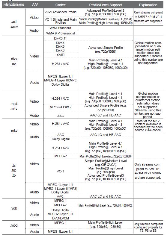

I have a LG 47LE550N TV and I try to watch DVD converted with MakeMKV. But my TV just support H264 video and aac or DolbyDigital audio from mkv files. So I try to transcode to a mpeg container with mpeg2video and aac audio. But the transcoding is not working. I get from log:

The AAC encoding should be fixed in 0.6. LG had problems with playing transcoded content in general though, so even if this worked I doubt it'd play in the end - unless LG fixed this in their firmware or new products.

that would work, but ac3 is normally supported with mpeg 2 video (DVD standard). The aac encoder is not very good in FFmpeg to date so AC3 encoding should work better.

I ran the FFmpeg with ac3 audio to a file and I can play that file in my LG TV.
So it looks like you are right. My LG TV has a problem with transcoded content. :(
