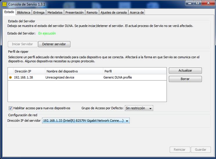

What does this mean: does not have access to the server
In status console name device show: unrecognized device
in profle: Generic DLNA profile
Bluray BD-F5100 not is recognized for serviio?

Post Tue Oct 22, 2013 11:32 pm
Re: Problem with BD-F5100/PE
Check the device in the console's status tab and make sure it's enabled (ie it has access to the server)

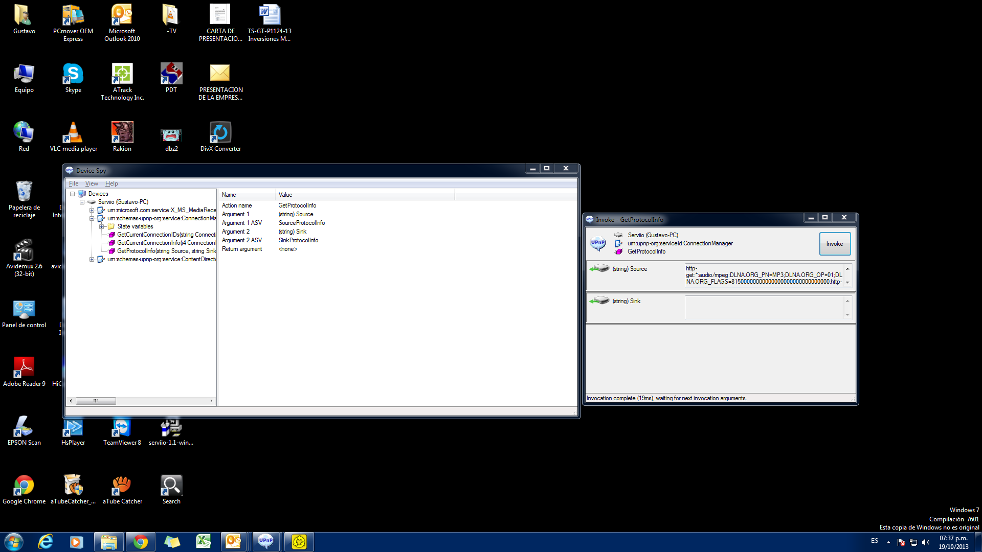

Console show: image001.jpg
Upnp show: image002.png
Why not recognize the device by Serviio or why not shown in "device spy" my bluray?

Post Mon Oct 28, 2013 7:36 pm
Please post detailed log of when you play a file that fails.
