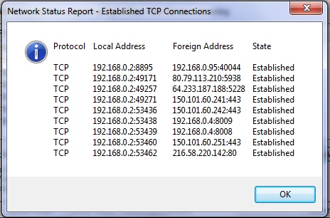

When you are streaming to a TV (Serviio via DLNA), and not pause, can you please right click on the WinHelper icon in the System Tray (bottom left - it may be hidden) and select "Network connections". This will then show the status of all active TCP sessions.
Do you see any connections from your server on port 8895 as is shown in the first row below:

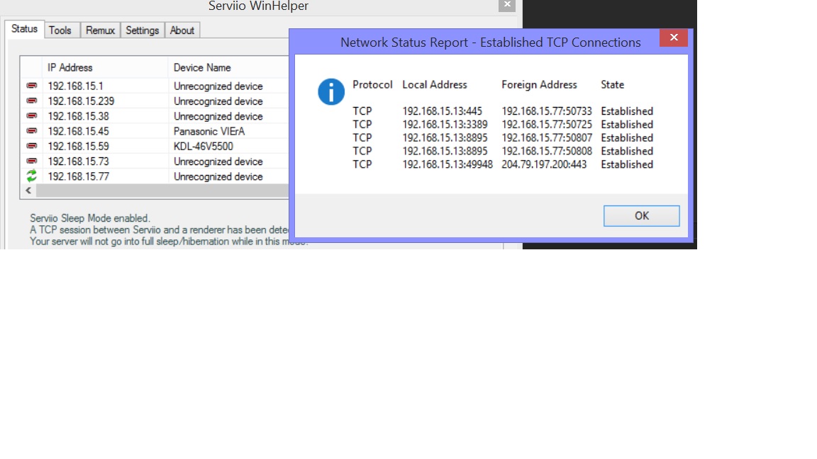

Did as you asked, here is the result
when I start streaming I get the Pic1 i.e. Port detected

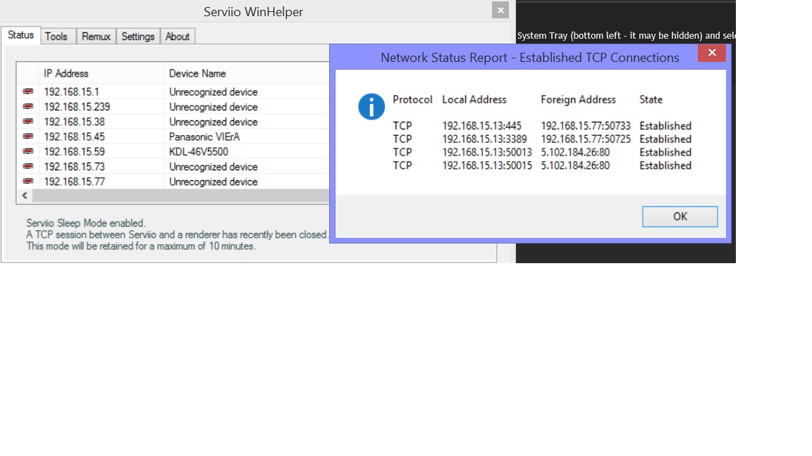

2 Mins later , see PIC2 i.e. no ports detected
NOTE: Video never stopped streaming
no port detected.jpg (122.36 KiB) Viewed 157667 times
8 mins later PC goes to sleep

Winhelper is doing what it should - detecting a TCP session on port 8895 from your server to a device and then inhibiting sleep. Once the session closes, Winhelper waits 10 minutes and then allows the PC to sleep.
The question becomes, why is the TCP session to port 8895 to 192.168.15.13 closed, even though the device is still streaming?
What devices is on .15.13? Is it a TV? Was the stream paused? If you press "Check Now" a few times, does the sleep mode change?

the device .15.13 is a Media server on win8.1 and is streaming to a networked win 7 PC
I did use check now and kept refreshing it and its always around 2 min mark it stops detecting PC connection
I have no idea whats closing the connections, i have checked that those ports are forwarded to .15.13 or left open for that PC

As I explained earlier, when you watch a movie on a PC (rather than a TV or BD Player or the like) it is not [generally] streaming via Serviio. Hence it does not use port 8895 and hence WinHelper won't detect it and keep the PC awake.
PC-to-PC video playing doesn't use DLNA, it's simply sharing the file. Not sure why there is a small detection at the beginning - suspect it is WIndows Networking briefly pinging the server, so that it appears as a "Network Device" (which is totally unusable).
The exception to this is if you use a "purpose-built" DLNA/UPNP client on your Win7 PC - something like VLC (connecting via the Universal Plug'n'Play option and then selecting the Serviio Server) or via Kodi (once again, connecting via the Serviio Server). This will stream the video from the Serviio Server using port 8895, and therefore be detected by WinHelper. Note that Windows Media Player is not a DLNA/UPNP client.
So my suggestions:
  • Try streaming to a TV and ensure WinHelper is keeping the server awake as it should be;
  • For PC to PC "streaming": I'm not a big fan of using DLNA/UPNP between PC's (I don't see the point - this protocol was designed for streaming to non-PC's) so I would either:
    • use Serviio's MediaBrowser (in which case WinHelper will keep the server awake, although this can be tricky at times - see some of the proceedings posts); or
    • look at another means to keep your server awake for this type of streaming - for starters, on your server, check your Power Options and against your current Power Plan and check the Advanced Settings, Multimedia settings and check the "When sharing media" setting.
