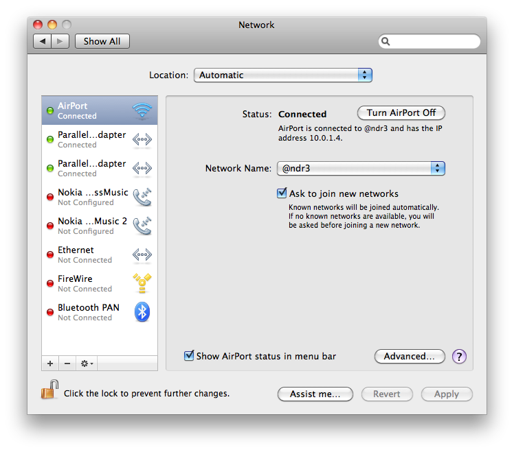

I have have tried diligently to go through the forums, but it seems that I cannot find the solution.
I have:
iMac (OSX 10.6.6)
Samsung C7000 (UN55 C7000 WF)
Samsung WiFi Dongle
I have used a few other DLNA servers and the seem to work (as in connect to Samsung). But want to/ try Serviio because of the others programs inability to transcode iTunes purchased content.
I have enclosed the log file and a few screenshots

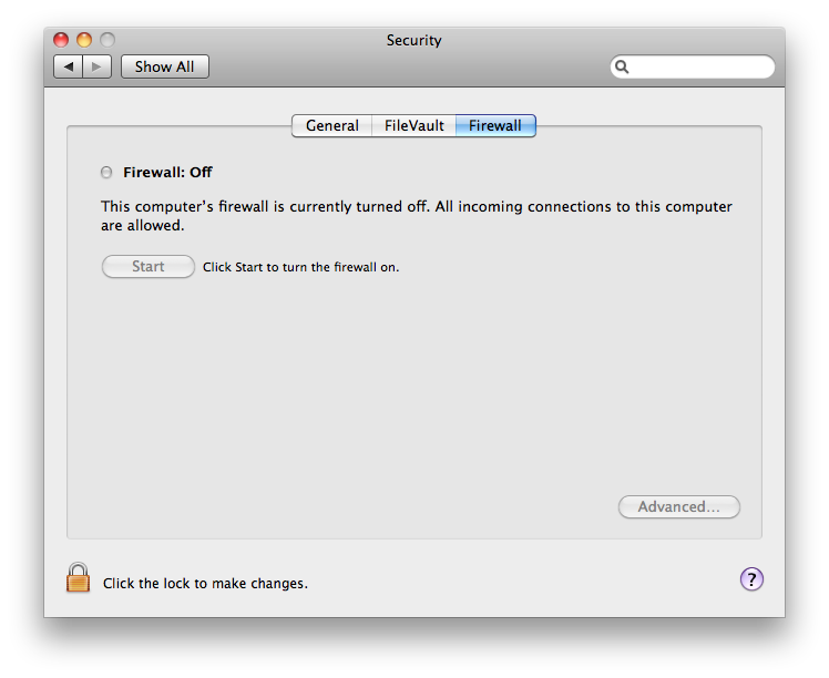

Firewall
Screen shot 2011-03-02 at 17.36.50.png (61.57 KiB) Viewed 11768 times

Is 10.37.129.2 the IP of your Mac? If not, put the proper one into Bound IP address field in the console.

OK, Not sure what changed the AM, but the Serviio server was viewable from my Samsun c7000.
zip wrote:Is 10.37.129.2 the IP of your Mac? If not, put the proper one into Bound IP address field in the console.
That was done yesterday, sorry forgot to include the screenshot
