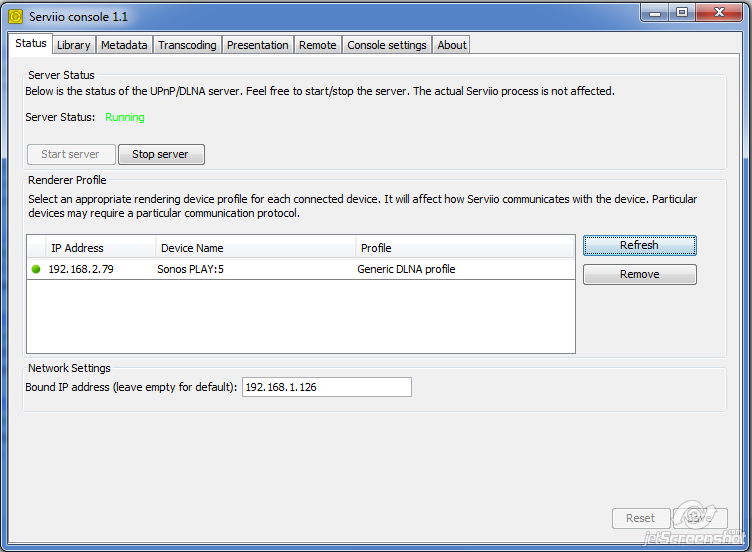

I have a windows serviio installation with two NICS, two routers and some virtual NICS.
I have tried both versions 1.1 and 1.2.
I have specified the correct Bound IP address on the same range as the TV.
I've disabled windows firewall and my antivirus
I've tried multiple service restarts etc.
I've read everything i can find on the subject.
I have static IP's on my network.
The strange thing is that even though I have serviio bound to 192.168.1.x range, It actually detects a device I have on 192.168.2.x range, so i'm assuming the problem is something to do with that.(see attached). If I just disable the 192.168.2.x NIC, then I get no results.
Dont know what to try next, please advise.
Thank you
serviio.zip
(62.71 KiB) Downloaded 468 times

The log is for 1.1, upgrade to 1.2.1 and try then (and post log if it still doesn't work)

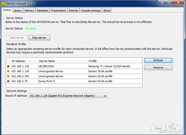

Thank you for the quick reply. I've updated back to the latest version, and now Serviio does see my Samsung TV, but the light is RED.
My TV can see the PC but trying to access it, the tv brings up the error "Request cannot be completed MEDIA PLAY with return to the main screen" "
please find log and screen shot attached. Thanks for the help!
serviio.zip
(36.45 KiB) Downloaded 448 times
Post Tue May 28, 2013 4:30 pm
Re: Samsung UE32EH5300 - Status = not found
There is no traffic from the TV in the log, check your firewall / router settings, as per FAQ.
The fact the tV can see the server may be down to cached values and when trying to access it it fails (as there is no communication setup)
