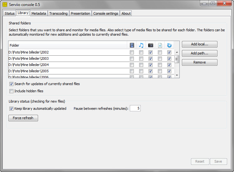

No they are just a few of my photoes. I have hundreds of photoes. My photoes are in forlders named:
D:\Foto\Billeder\2002
D:\Foto\Billeder\2003
D:\Foto\Billeder\2004
D:\Foto\Billeder\2005
....... etc
The only folder I can see and who contains photoes is
How do I make a detailed log? I tried making changes in log4j.xml
putting "Debug" in
<category name="org.serviio">
<priority value="Debug"/>
</category>
That is not correct I guess
