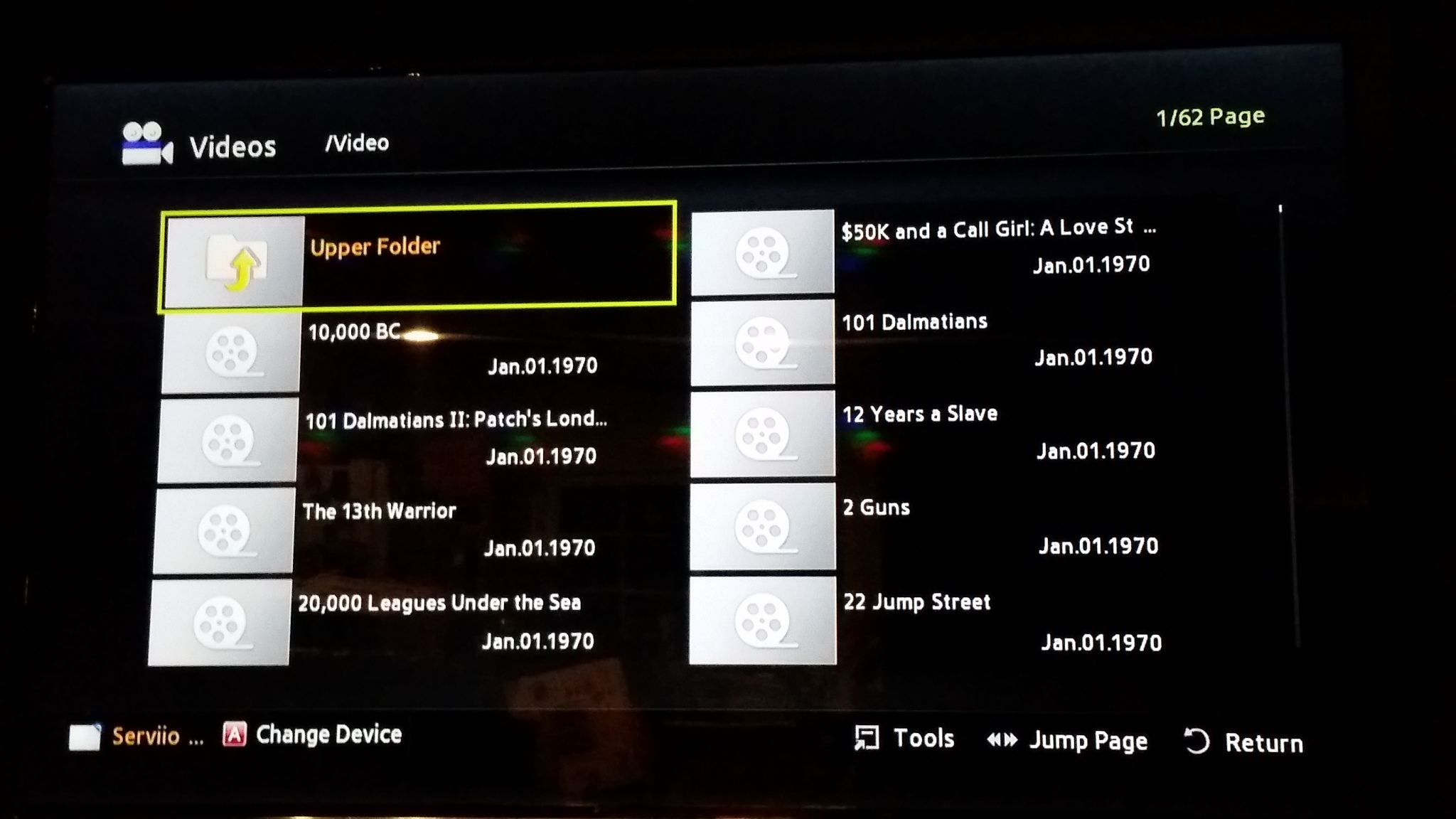

Can you post an image of where it appears so?

Here is pic

Yep, that's what my H series BD looks like too. The HU8550 TV has dates all over the place, some like this and some 100 years in the future :o . Not a clue where Samsung is getting the information.

The Samsung devices all seem to have under the tools menu an Information screen, which shows the video and audio codecs, run time, and release date. In almost all cases, the release date listed here is accurate. Why the browse screen shows the wrong date (in the BD player case, just like the picture he posted shows, every one of them is Jan 1, 1970), I have no idea.
For my TV, same issue, although the dates are not all identical. A few are accurate, some are a past date or near future, and some are over 100 years in the future :o . How they figure the movie was released in 2119 is anyone's guess! :lol:
