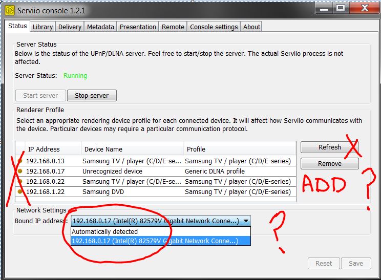

I have been using Serviio for years, it is the greatest tool for my media library. I stream through Samsung BD C6900.
I performed an upgrade of Serviio to release 1.5.2 and now my BD can't see the computer.
I tried to revert back to earlier version and even did a computer system restore, but still no computer is shown from the BD.
I did a factory reset on the BD player, everything internet works except I can't see my own computer through Serviio.
I use Static IP,
I pinged the IP of the BD Player and it is found
Reset Server many times....Connections are verified.
This version of Serviio does not have an ADD button for new devices, How can I manually add a new device with specific IP address.
Can anybody PLEASE make some suggestions, I miss my Serviio services.

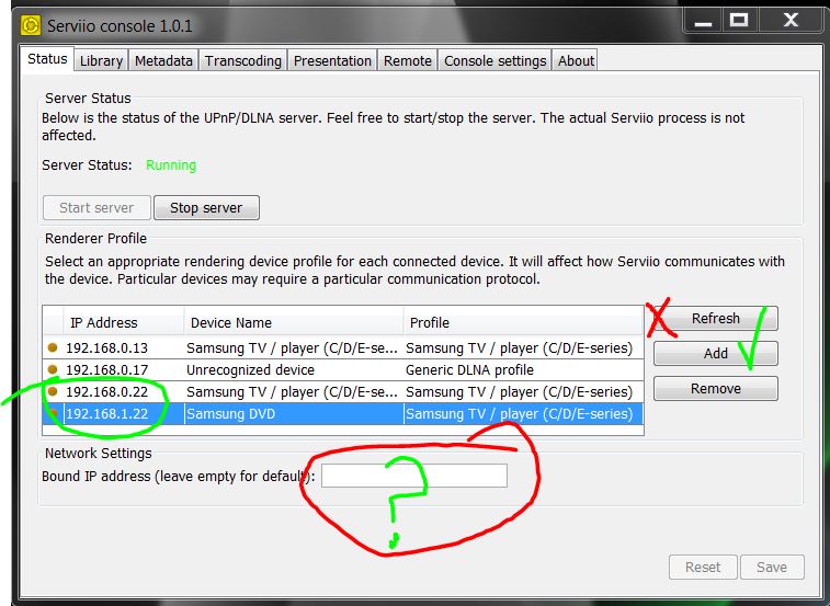

I removed Serviio and started from scratch with an earlier release 1.0.1
It contains the ADD and REFRESH buttons but neither are bringing up any results from a potential of 6 devices.

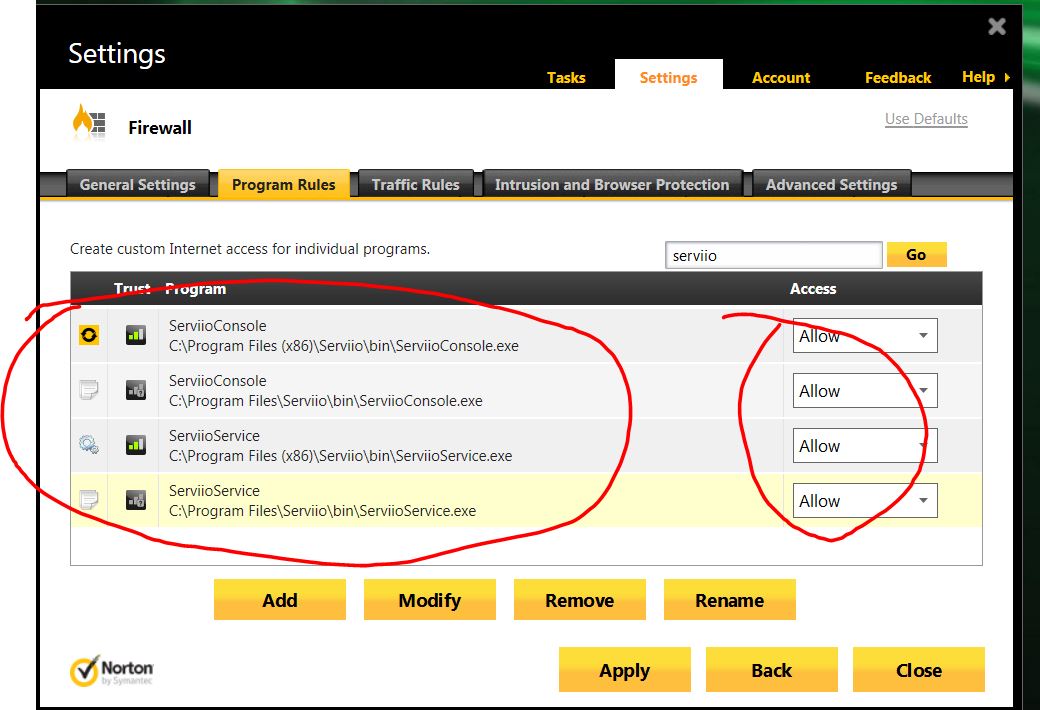

So i checked my Norton Firewall settings and added Serviio from the Program Files directory.
That still did not bring up any devices.

Disabled all firewall activity in Norton
Installed Serviio 1.0.1 - nothing refreshes in the list of devices
Manually added the device with correct IP address
Nothing shows in up when the BD Player is started.
Changed the rules in Norton to allow Serviio - no change

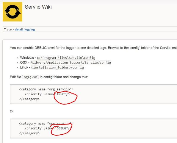

Post a detailed log showing Serviio starting. I am concerned that the Bound IP address box isn't populated which suggest the WIC can't be found. The screen shots - are they from the working or non-working boot ( or one of each?)

DenyAll wrote:Post a detailed log showing Serviio starting. I am concerned that the Bound IP address box isn't populated which suggest the WIC can't be found. The screen shots - are they from the working or non-working boot ( or one of each?)
Thank you for your reply. I have attached the log file found in the Serviio config directory. I hope these are the startlog you were referencing
Log4j.xml

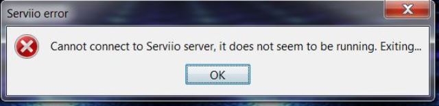

I clicked on the link in your reply that showed to make a change in the file (capture 1) change INFO to DEBUG but then Serviio wouldn't start (Capture 2) so now i changed it back
As for your question on the uploaded screen shots (BTW I apologize for the size of those pictures, I have to learn to reduce them because they come across as huge).
Those are taken after the new installation which is NOT working. I manually added those devices after installing version 1.0.1. I used the same IP addresses that were in the previous working version
However, I do not have that capability for any version following because there is no add button. The two screenshots show two different versions. The reason for this is to show how there was an add button that disappeared in the next version. When I reinstalled version 1.0.1, no devices were detected this screen was empty.
When I installed a later version without the add button no devices are shown.

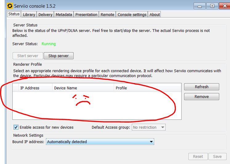

Here is the result of wiping out everything and doing a fresh new installation of version 1.5.2
It does not pick up any device.

On the status panel, you have "Auto Detect" selected for your IP address. Does this install have a static IP address for the computer? If not, I highly recommend it. Then you can select the IP address in the box, rather than letting it detect. Then restart the Serviio Service (easiest to just reboot the computer) then see if things begin to show up.
If you have questions about configuring a static IP, there are lots of web sites that can help, and we can too if you still have issues.
