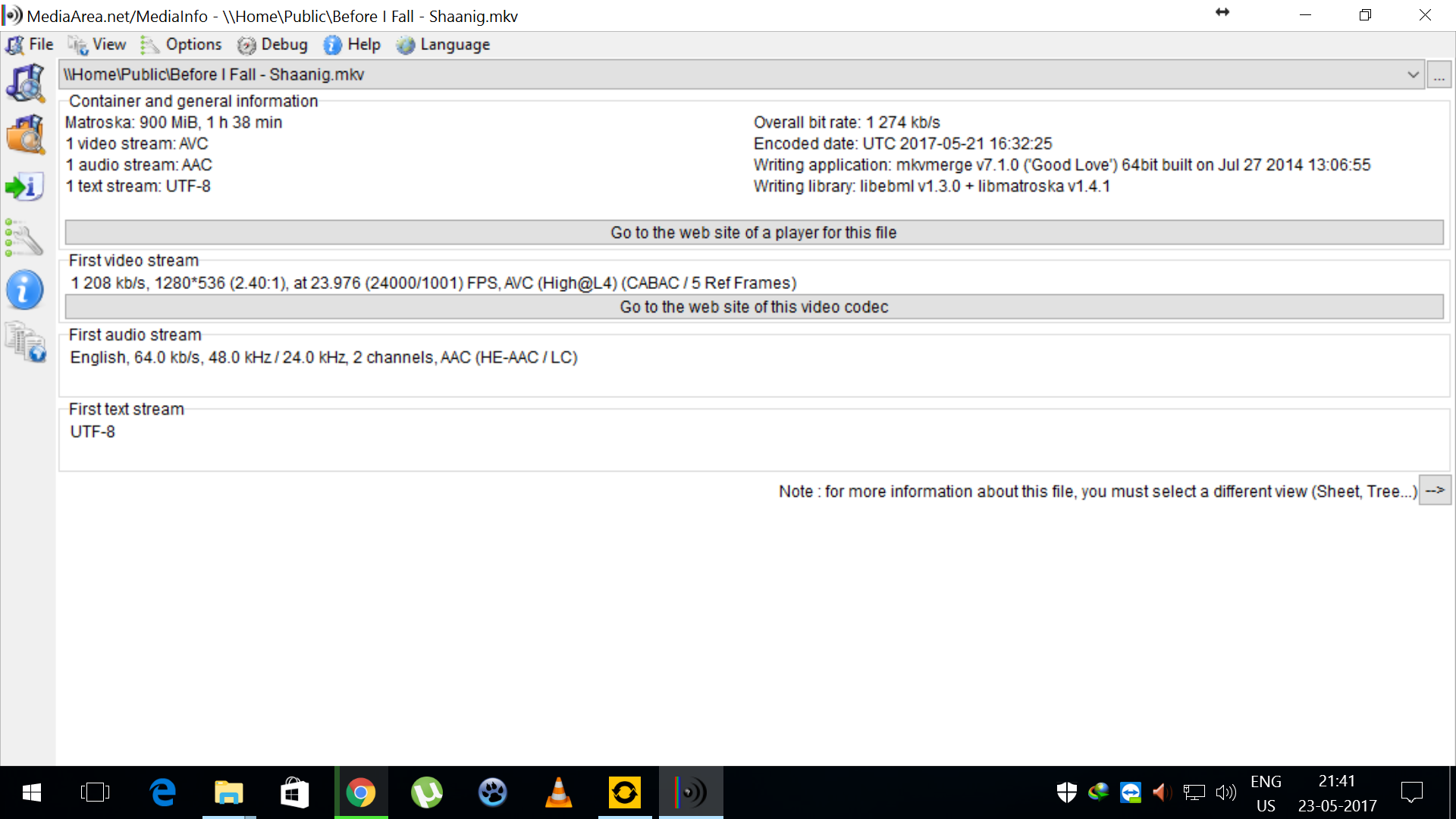

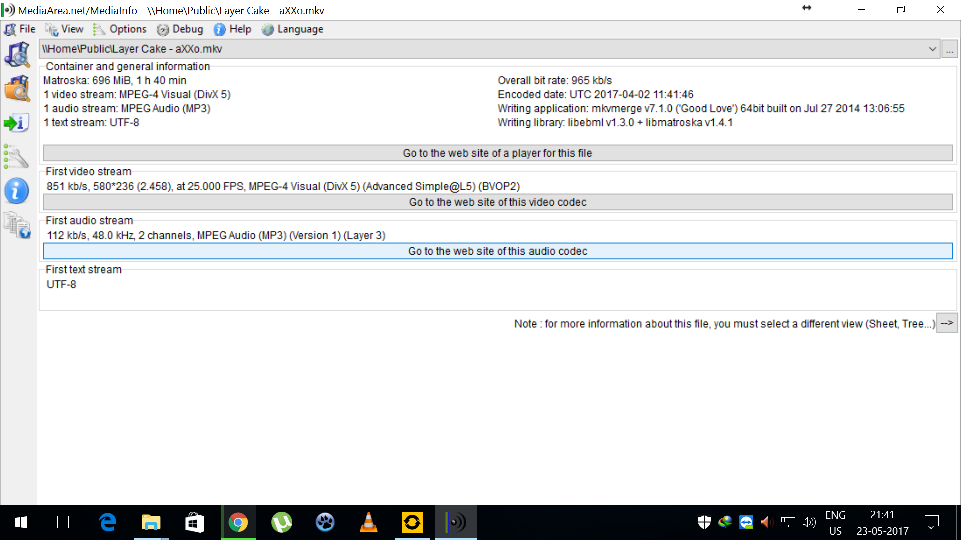

Update:
So I get the info from mediainfo app.
This is the h265 File
This is the mp4 file.
