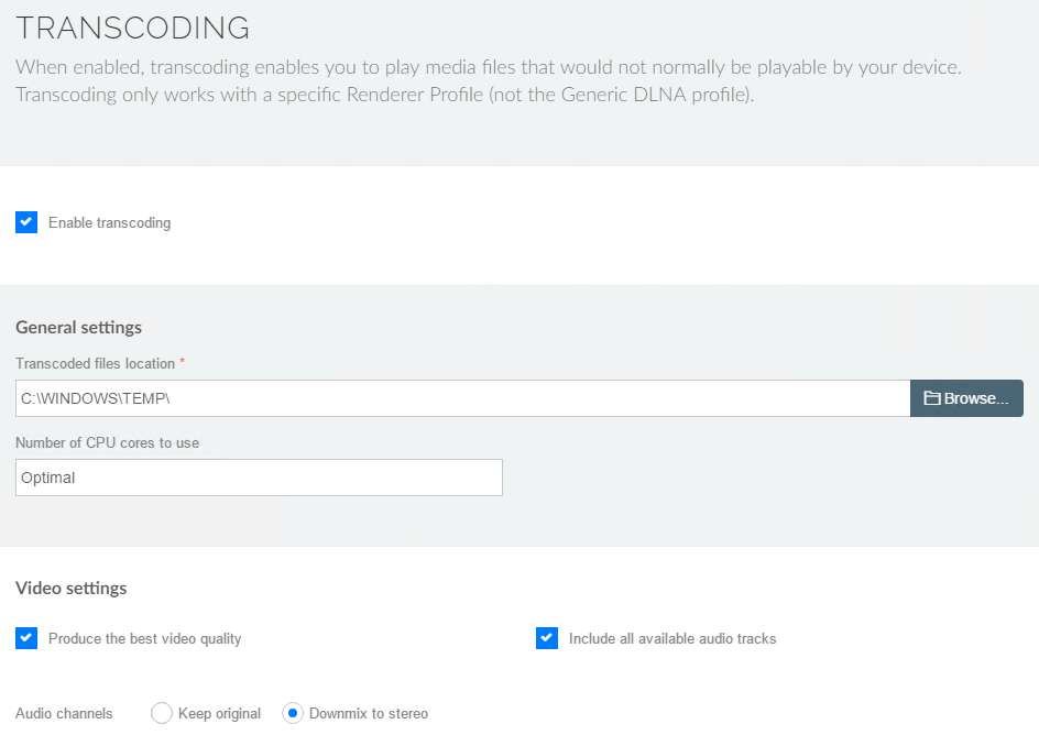

Hi zip - thanks for the reply.
I'm not sure I understand... Are you saying there is no fix possible? That seems to be quite unlikely as both TVs are fairly recent (3-4 years) and serviio seems to be the best streamer out-there. There must be a fix? I can't imagine being the only one person in this situation.
You mentioned they need to be transcoded? I have that options specifically checked in Serviio's parameters (see pic attached). Isn't "transcoding" exactly what serviio is supposed to do? Or perhaps serviio 1.9.1 still needs to to be updated to support such transcoding?
In the meantime, I run HDMI cable from computer to TV and bypass Serviio all together - not ideal.
Thanks,
You can probably tell that I'm not an expert at all this. I appreciate any guidance that could be provided.

placroix: I don't believe either of your TVs support H.265 video. That's why they need to be transcoded. And transcoded files cannot be fast forwarded or rewound with almost any player. With my Samsung TV (JU7100) it won't even play transcoded files. And it's a Samsung issue, not Serviio. So if your TV will not play H.265 (and I doubt either do), there is no workaround and no fix. And Samsung is not going to add support for H.265 to a non-4K TV.
