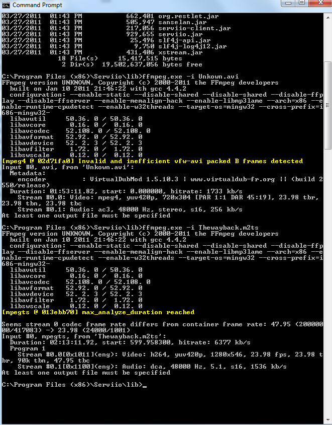

Which profile are you using with the plasma? and post ffmpeg -i of the file

ffmpeg -i

Unkown.avi is delivered in native AVI format.
The Way Back.m2ts is delivered in native AVC_TS_HD_DTS_T format.
Its seems good for me.

It's possible that WMS transcodes the file and the TV likes it more. Serviio sends the file natively, as it should be supported by Samsungs, but looks like the TV cannot play it properly. You could try transcoding everything (try for example the DirecTV profile), but it's a bit of overhead.
