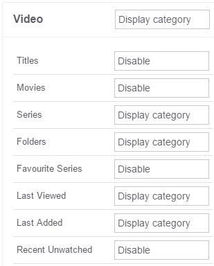

Video categories I have choose to be displayed on TV (last added and last viewed) do show on TV but TV stops working when trying to access them.
Serviio v 2.0 on Windows 10 x64 Home, last update installed, TV Samsung UE37D6500
I have attached a screenshot of the categories in use. Series and Folders open, last added and last viewed give an error.

Which profile is assigned to your TV? Serviio attempts to assign the best profile for a device, but sometimes it doesn't use the best. In theory your TV should have the "Samsung TV / player (C/D-series)", but sometimes a different profile works better.
I don't have that old of a Samsung set, but the two I do have display fine. Can you be more specific about which category you are accessing that causes the TV to stop working? Is it the Last Added and Last Viewed, or is it any of them? And exactly what does the error say?

Thank you for your answer. i attached a screenshot of how my TV is displayed.
The name stands correct.
I do not use many categories for video, mainly last viewed and last added.
Both were working fine before update to v 2.0. last added was working after that.
Now last added when accessing returns to the video root and doesn't display any content
Last viewed starts spinning the wheel and doesn't stop until I shut down the TV.
