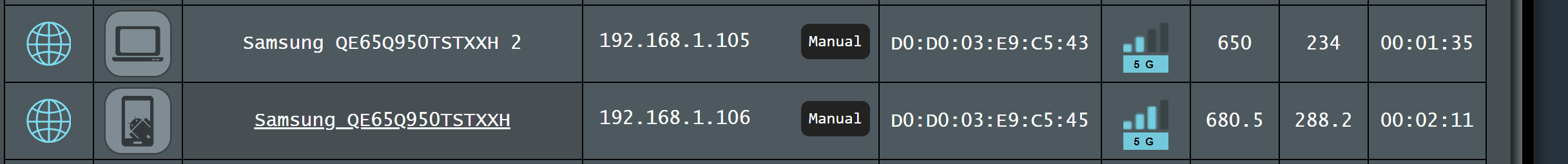

Dear All, having a small problem with Samsung QE65Q950TSTXXH and Serviio (on QNAP server)
Problem is that TV have 2 wireless networks and Serviio using random IP from those 2.
and after turning off TV, Serviio resets settings I made for TV and changes the profile to default, but without it, works, but with some issues.
So, every time, before using Serviio, I need to check profile settings and change it to the correct one.
BTW, with "NU" profile everything works fine for Y2020 QLED.
So, question is: is it possible somehow fix profile settings for both IP, so it will not reset after TV restarts?
Attachments: all proofs.
network map.PNG (53.99 KiB) Viewed 17825 times

It`s not possible to use only 1 IP address on TV - checked it`s already
Exactly, the problem is that even if i assign correct profile to both IPs, after TV restarts one of 2 will go to default
And it`s not possible to predict which one.

I agree, it should be like you mentioned, but it`s not. Could be also TV problem and there is a chance it will be corrected with new firmware, since there was no any updates available yet.
Both IPs I assigned manualy - 105/106, so they are not changing, but anyway as I explained, profile settings resets to default after any action (tv restarts, router restarts, serviio restarts)
Another concern is that Serviio recognize only 1 IP as TV - second one - always shows as unrecognized device
The only solution now - I`m using LAN cable with current TV with single IP

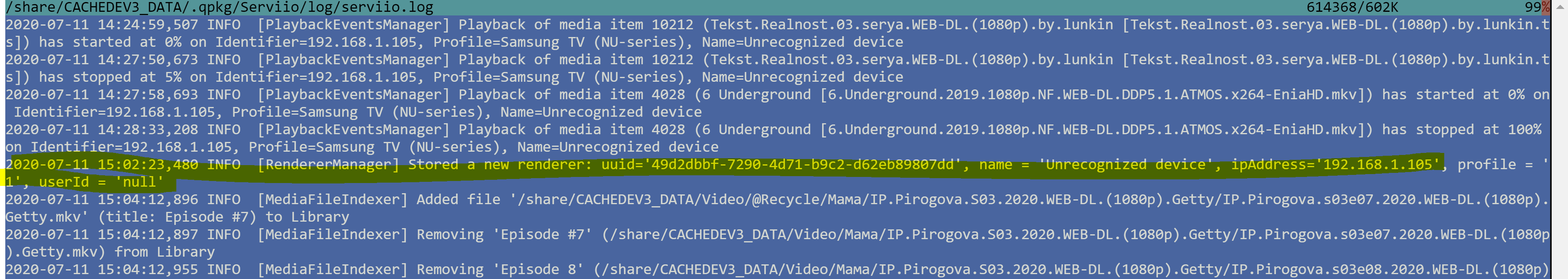

I tried to block one of the MAC addresses @ router, but it followed by disconnects and restarts of Serviio service from TV
When disconnects, there are nothing in router log and just one string in serviio log:
2020-08-15 21:31:36,358 INFO [RendererManager] Stored a new renderer: uuid='c54bf0bb-52c8-4acc-93f6-9c7d41d6991b', name = 'Unrecognized device', ipAddress='192.168.1.105', profile = '1', userId = 'null'
If to change profile to Samsung TV (NU-series) it will go back to "generic" after tv restarts
So, question, is it possible to copy all NU-series settings to "generic"? So, I will not care anymore to change profile.
