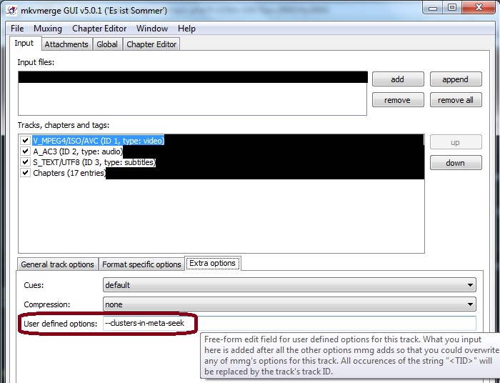

The option goes in the 'User defined options' field on the 'Extra options' tab. Just paste this in, including the hyphens:
--clusters-in-meta-seek
You need to highlight a track to get to the Extra Options.

Here's a screen shot of the setting in mkvmerge 5.0.1. You might need to scroll down to see the whole thing.
Notice you need to highlight a track (eg Video) to get access to the Extra Options tab.
