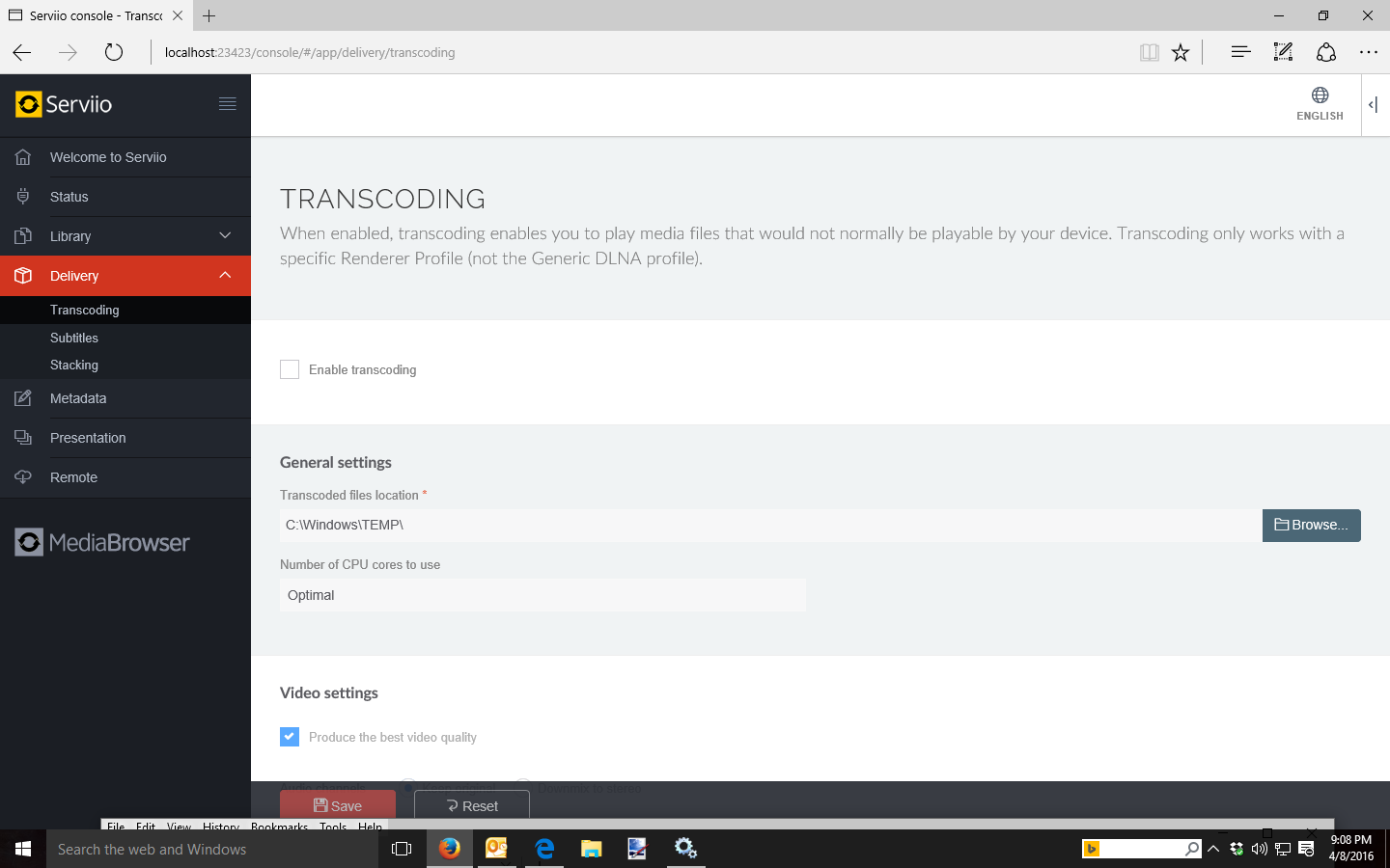

Post Thu Apr 07, 2016 7:27 pm
Re: FF/Rew not working post-upgrade
Thanks. Just to be clear, it was working on which version, and which version are you using now (it looks like 1.6, but 1.6.1 is the latest).
The file is transcoded, so that's why the TV won't allow you to seek. Try to disable transcoding and play the file again.

Post Sat Apr 09, 2016 3:06 am
The previous version I was running was likely in the 1.5 series then. I upgraded not too long ago, and it was a major version upgrade (web interface, etc.). I'll try to disable transcoding and see if that works! I never changed any transcoding settings I don't think.
talanmawr
Posts: 27
Joined: Tue Aug 13, 2013 3:39 pm
Post Sat Apr 09, 2016 3:15 am
Ok...FWIW...the transcoding option wasn't checked. So, I'm not sure that's it. (attached screenshot)
