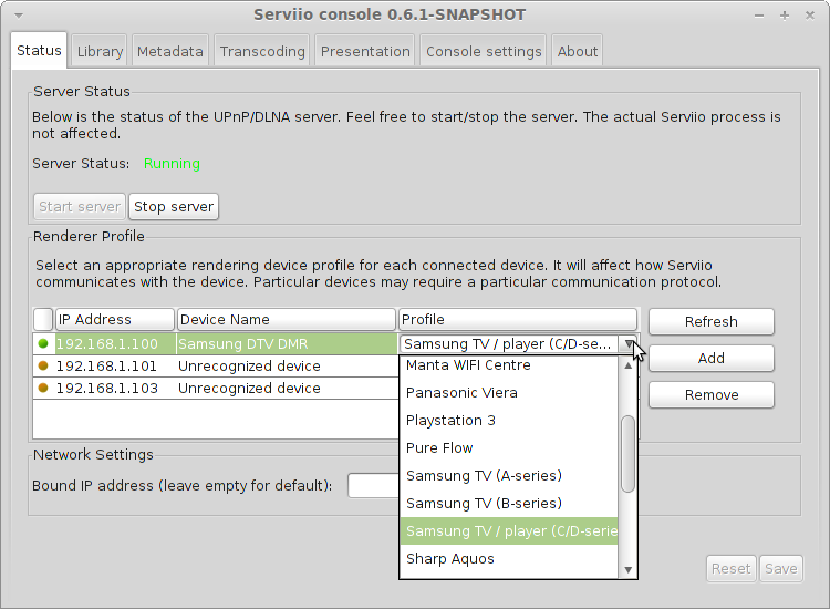

I have a strange intermittent connection between my desktop running windows 7 and the serviio server and my Samsung UN55C8000.
Both are set to Static IP addresses and I have set the Bound IP to the computer's IP.
I can see the IP of the TV in the device list and it has a green dot next to it, indicating a good connection.
However, I cannot see Serviio as a device on my TV. I previously was able to see it, then it just went away for no reason.
The TV still has a good connection on my network as I can use other Apps on it as well.
I have uploaded some of my recent logs to try and help.

can you prvide a DETAILED log please :) it could also be something as simple as needing to restart your router.

Re: Help with UN55C8000
I activated the log according to the wiki here and that was the output. Is there another setting that I have to add in the file to output a more detailed log other than changing INFO to DEBUG?
I have also restarted the computer and that did not seem to help.

jpinn wrote:I activated the log according to the wiki here and that was the output. Is there another setting that I have to add in the file to output a more detailed log other than changing INFO to DEBUG?
Thanks again.
Are you sure that serviio is setting more than just a generic dlna profile...I had the same problem...resetting the console to the correct profile corrected the situation. Have a look at the gui....if it says generic dlna then that is what has happened and you will have to reset to c/d series samsung like I did.
corrected console profile choice for c/d allshare
Screenshot-Serviio console 0.6.1-SNAPSHOT.png (68.45 KiB) Viewed 6267 times
