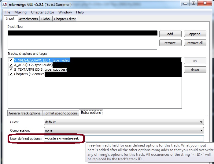

I was able to 'fix' an mkv so that the skip/jump works, using this setting:
Digitoxin wrote:The .MKV needs to be muxed with the option --clusters-in-meta-seek in mkvmerge. This was turned on by default in previous versions, but is off by default now. This is required to be able to jump backwards and forwards on Samsung players.
from this thread:http://forum.serviio.org/viewtopic.php?f=10&t=3267
FYI I used mkvmerge 5.0.1. The 'bad' file has EbmlVoid size 4044 and the 'good' file 4027.

Here's a repost of my screen shot of this setting.
You might have to scroll down to see the whole thing.
from http://forum.serviio.org/viewtopic.php?f=10&t=3267&p=28862#p28862
Here's a screen shot of the setting in mkvmerge 5.0.1.
Notice you need to highlight a track (eg Video) to get access to the Extra Options tab.

Thanks for the clusters-in-meta-seek option.
I went to Muxing->Add command line option.
There I selected the option in the dropdown list. OK.
Then File->Save settings...
Saved the .mmg-file in the same place I have the latest copy of mkvtoolnix. Named it "clusters.mmg".
Then I created a new shortcut (or change the one you usually use) to "mkvtoolnix-path\mmg.exe" "mkvtoolnix-path\clusters.mmg". This way the shortcut will always load this setting.
