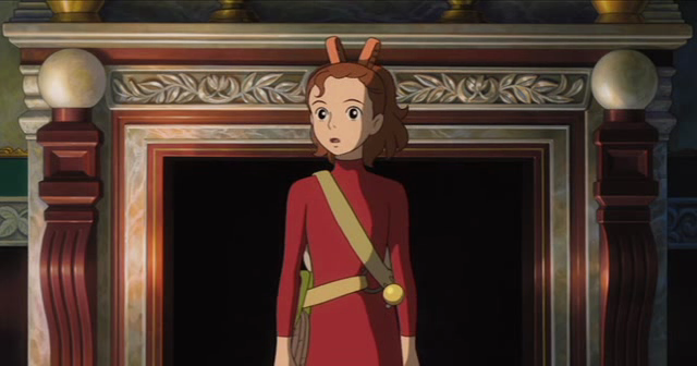

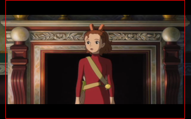

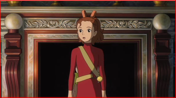

Post Sat Aug 06, 2011 7:25 pm
EXAMPLE
Stream #0.0: Video: mpeg4, yuv420p, 640x336 [PAR 1:1 DAR 40:21], 23.98 fps, 23.98 tbr, 23.98 tbn, 2997 tbc
DAR: Display Aspect Ratio is not conventional (4:3 or 16:9)
    This file is transcoded with ffmpeg (serviio 0.5.2)
ffmpeg.exe -i "Test1.avi" -y -threads 2 -vcodec mpeg2video -b 17000k -maxrate 17000k -bufsize 5097k -r 24000/1001 -g 15 -copyts -acodec ac3 -ab 192k -ac 2 -map 0:0 -map 0:1 -sn -f mpegts "TEST.stf"
Stream #0.0: Video: mpeg2video, yuv420p, 640x336 [PAR 1:1 DAR 40:21], q=2-31 , 17000 kb/s, 90k tbn, 23.98 tbc
The red rectangle represents the area visible on the Sony Bravia TV screen
- Some pixels were lost on left and right (not on screen displayed)
- The video is crushed (see fireplace globes, or Arrietty face)
- TOP /BOTTOM black bars were added
    Workarround: On Sony Bravia TV Display option : Select ZOOM
- The video is not crushed or stretch : OK
- No black bars : OK
- But some pixels were lost on left and right : BAD

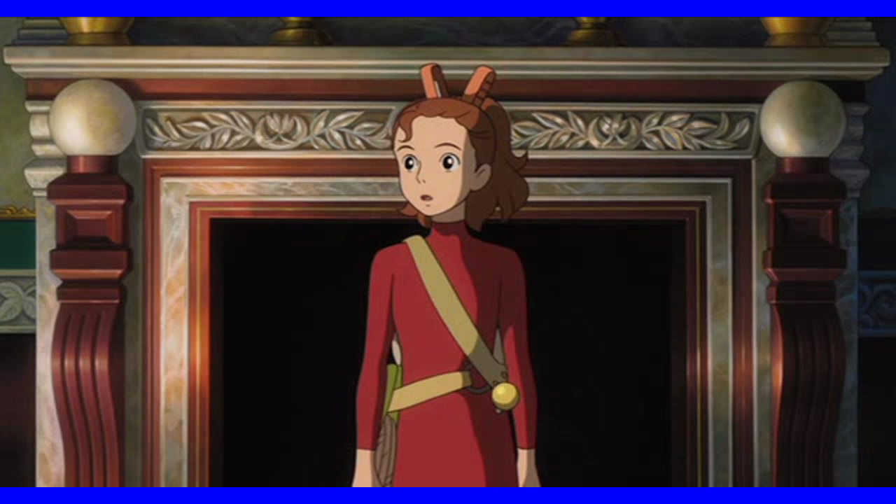

Post Sun Aug 07, 2011 9:25 am
FFMPEG VIDEO FILTERING
    FFMPEG VIDEO FILTERING USED : SCALE, PAD and SETDAR option
ffmpeg.exe -i "Test1.avi" -y -threads 2 -vcodec mpeg2video -b 17000k -maxrate 17000k -bufsize 5097k -r 25 -g 15 -vf "scale=1280:1280/640*336","pad=1280:720:(ow-iw)/2:(oh-ih)/2:blue","setdar=4:3" -copyts -acodec ac3 -ab 192k -ac 2 -map 0:0 -map 0:1 -sn -f mpegts "Test1-Final.avi"
Input #0, avi, from 'Test1.avi':
encoder : Lavf53.6.0
Duration: 00:01:00.91, start: 0.000000, bitrate: 1395 kb/s
Stream #0.0: Video: mpeg4, yuv420p, 640x336 [PAR 1:1 DAR 40:21], 23.98 fps,23.98 tbr, 23.98 tbn, 2997 tbc
Stream #0.1: Audio: mp2, 48000 Hz, stereo, s16, 64 kb/s
[buffer @ 018dbfa0] w:640 h:336 pixfmt:yuv420p tb:1/1000000 sar:1/1 sws_param:
[setdar @ 0194d640] a:4/3
[scale @ 018e4000] w:640 h:336 fmt:yuv420p -> w:1280 h:672 fmt:yuv420p flags:0x4
[pad @ 018c4040] w:1280 h:672 -> w:1280 h:720 x:0 y:24 color:0x29F06EFF[yuva]
[setdar @ 0194d640] w:1280 h:720 -> dar:4/3 sar:3/4
Output #0, mpegts, to 'Test1-Final.avi':
Stream #0.0: Video: mpeg2video, yuv420p, 1280x720 [PAR 3:4 DAR 4:3], q=2-31, 17000 kb/s, 90k tbn, 25 tbc
Stream #0.1: Audio: ac3, 48000 Hz, stereo, s16, 192 kb/s
Stream mapping:
Stream #0.0 -> #0.0
Stream #0.1 -> #0.1
Sony ZOOM display option not needed
The following image is the screen display result, the "blue" area is the padding adding by the ffmpeg option, must be set to black for the final solution.
I found out that the TV doesn't deal with non-HD stuff properly! so I need to expand/upscale to a HD : 1280x720 resolution.
