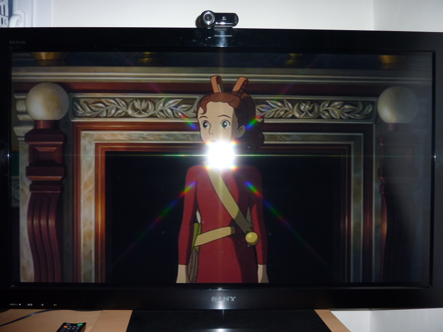

augustf wrote:I just tried Test1_640x336_short.avi. It occupies the center 1/3 of the screen at "Full" (much less with the "Normal" setting). Applying "Zoom" gives the most picture on the screen and doesn't appear to lose any pixels. At "Zoom," only about the top and bottom 1/4 of the screen are black. I'm assuming this is about normal.
Could you post a photo to be sure?
EDIT : This is mine:
Test1_640x336_short.avi on Sony Bravia 2010 model
