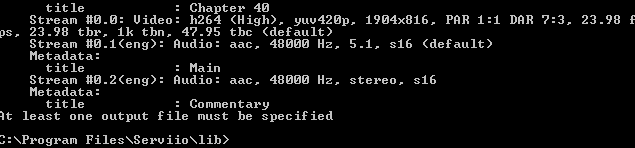

heres screenshot from ffmpeg

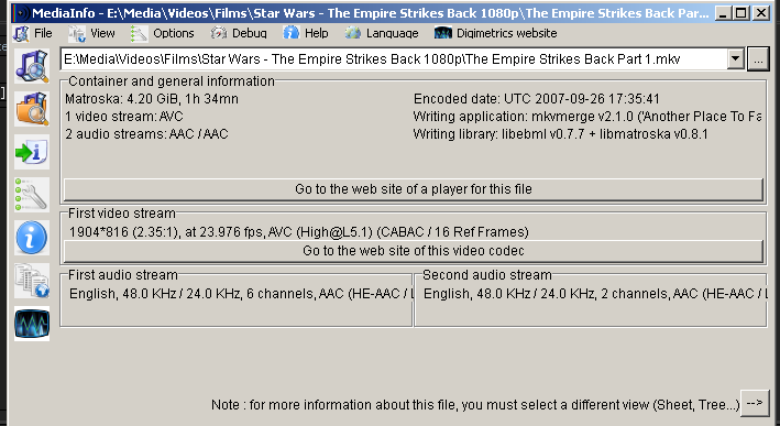

media screenshot

Video Codec is probably the problem: AVC High Level 5.1 (CABAC/16 RefFrames) is too high: For sony devices it seems that 4.1 is the max.
Could you rename the file, force library refresh and check the log file?
->This file must be detected with an high level profile.
Could you also check the log file when you start this movie?
->must be transcode into mpeg2video with ffmpeg.

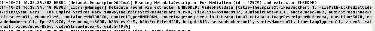

Post Sat Oct 22, 2011 6:14 am
Re: MKVs Stuttering
heres the log when the file is added. Two useful things for log files, Trace32 which comes with sccm toolkit is excellent for viewing log files as it auto refreshes, 2 - a program called VIM is excellent for opening huge log files without crashing.

marculos wrote:Two useful things for log files, Trace32 which comes with sccm toolkit is excellent for viewing log files as it auto refreshes, 2 - a program called VIM is excellent for opening huge log files without crashing.
As you've probably noticed, Serviio's logs segment as they grow, with the latest one always being called serviio.log, so they're never too big. Rather than posting screenshots it's far easier to simply open them in Notepad and paste the relevant bits here inside [code] tags so they are collapsed until clicked on, for better forum readability.
