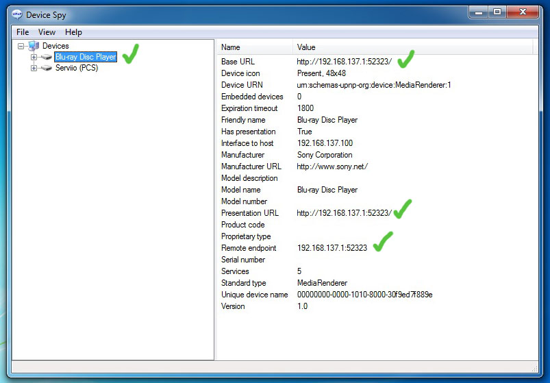

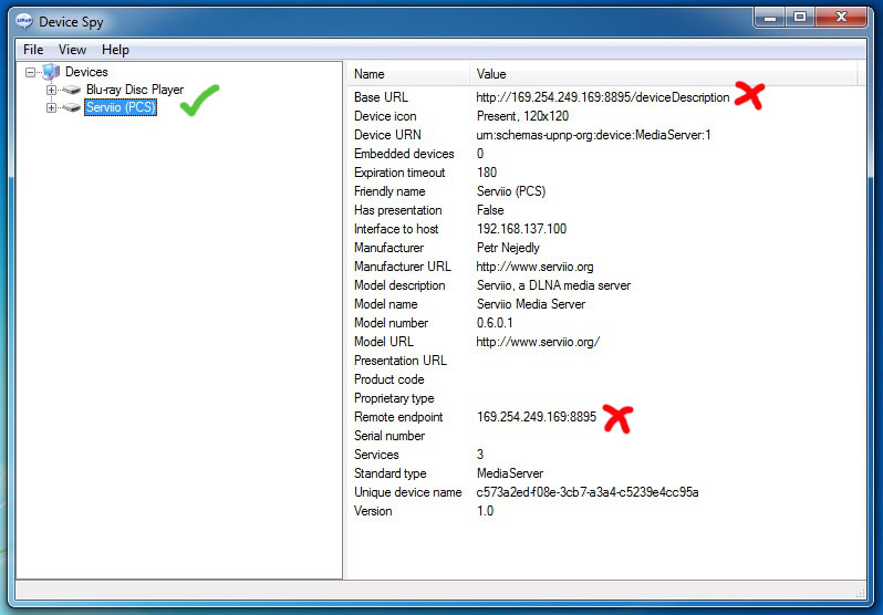

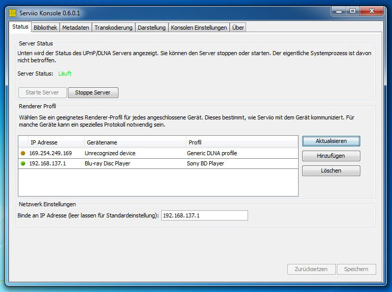

Post Mon Jan 02, 2012 11:50 am
Re: SONY BDP-S780 - My device doesn't see Serviio
I do not understand!
Trouble connecting to my Renderer BDP-S780.
Pc <-- > BDP-S780
(two network cards, ICS) no Router, Internet no problem
Suddenly, the renderer is no longer serviio. Renderer detected in console, but can't see Serviio. I have changed nothing.

please help,
eclp :|
Post Mon Jan 02, 2012 3:58 pm
make sure you have set Reserved/preferred IP address's on your router as your IP have change so now serviio is not picked up.
eclp
Posts: 102
edit
Funny, after a reboot it works again. Why?
Post Mon Jan 02, 2012 4:02 pm
network conflict some were very hard to troubleshoot remotely.

Only after PC restarting finds the renderer serviio server. Otherwise he findert not serviio.
What can I do? Can this be fixed somehow?
eclp :?:
eclp
Posts: 102
Post Wed Jan 04, 2012 9:15 am
The problem seems solved.
The error was the wrong IP address of the pc running serviio bound in ip field.
Strange that there is no one noticed.
:D

Re: [SOLVED] SONY BDP-S780 - My device doesn't see Serviio
teach me to trust the user to know there own IP :roll:
