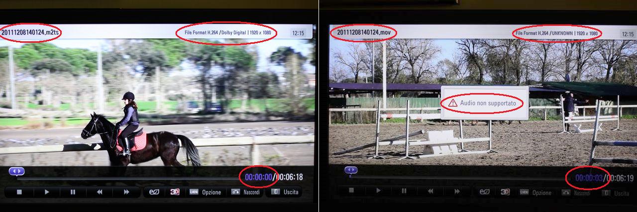

Hi guys.
Sorry for my bad English.
I have an LG 32LW570G. When I play video .m2ts (made with my Sony HDR-SR12) via DLNA, I can only see the first 30 seconds then Serviio skip the next .m2ts file in my video folder.
If I pause the video around the 25th second and then I play again, I can see another 30 seconds and so on ...
If I play .avi or .iso all work right .

My TV don't list *.m2ts file but if i rename file .m2ts in .avi on USB stick i can play it (the whole file).
PC:
I try to rename file .m2ts in .avi on pc folder but I can play only 30 sec.

can you try to remux the file to mov and try it then?
ffmpeg -i S:\_Sony\Video\20111208\20111208140124.m2ts -vcodec copy -acodec copy -f mov S:\_Sony\Video\20111208\20111208140124.mov
rosario.f
Joined: Sat Dec 17, 2011 7:56 pm
Post Thu Dec 22, 2011 11:36 am
Re: LG 32LW570G and .m2ts files problem (only 30 seconds)
ffmpeg output
Y:\appo>ffmpeg -i 20111208140124.m2ts -vcodec copy -acodec copy -f mov 201112081
40124.mov

mov file
  • Audio: NO
  • Video: ok, i play the whole file
  • Timeline: ok
m2ts file
  • Audio: ok
  • Video: about 30 seconds
  • Timeline: not run
See attach file
