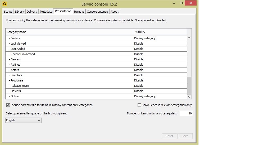

stream2.jpg : the screenshot of Serviio's presentation tab. Unfortunatelly there cannot be shown everything, so I scrolled to very down and You can see the "video: section of presentation tab. Very last row is seeting of "online" folder of Video section.

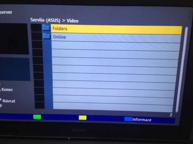

stream3.jpg : photo of Panasonic TV - I suppose it proves Serviio is working ( :-) ) and You can see it shows the Video folder as configured in previous step. So far everything is allright.

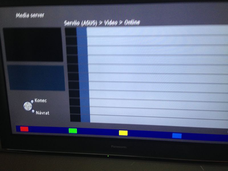

stream4.jpg : photo of content of "online" folder in "video" folder in TV. You can see no stream available, although in stream1 Serviio is able to check the stream
I check everyhting twice, and really dont know, what going on why TV is not showing the online stream which serviio can see...
