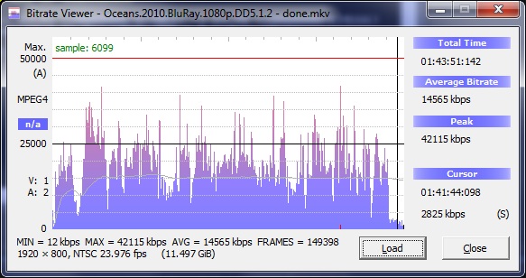

Basically I'd like to have some thoughts on the following: yesterday I watched a 1080p movie and 90% of the time it's very smooth, but unfortunately sometimes it's not, it's choppy and stutters for like 10 secs then gets back to normal. Also, it always stutters at the exact same times.
Now I understand this probably has to do with the bitrate since I'm on WIFI (or at least partly):
- computer sends the data to the router : WIFI
- router to TV: WIRED
I ran bitrate viewer on the movie I watched yesterday and here's the result
I seems to me that everything above 22mbps lags. What I don't get is how there can be such a huge difference in bitrate at times (average is perfectly fine)? Does this have to do with the amount of details on the image or has this more to do with bad video encoding? From the graph you can see it's clearly not constant... I wonder if that's the movie's fault or the encoder's fault...
Any highlights on that? Any idea on how to fix that?
Thanks a lot :)
Cheers
Larry

Yep, your peak bitrate is pretty high and is most likely the problem - probably on the device side as well (the decoding chip cannot cope). Higher bitrate is usually in a fast moving scenes or in scenes with high number of artifacts (e.g. 'old movie effect' - distorted image).

1- Reencode with external tool the original movie with more accurate maximum video bitrate option (for example 17Mbps)
2- With Serviio, editing profile to transcode h264 video codec into mpeg2 video with max video bitrate option "maxVBitrate" (but this will be for all h264 video despite bitrate value and very eater for CPU)

I think that these two movies are really not appropriate for Upnp/DLNA streaming over LAN, devices are currently limited to 20Mbps or 25Mbps (MPEGTS/AVC/AC3).
