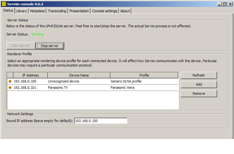

I have attached my serviio status screen:
serviio.log:
(205.41 KiB) Downloaded 1002 times
My IP addresses are:
PC 192.168.0.100
Modem 192.168.1.1
Wireless router 192.168.0.1
Panasonic TV 192.168.0.101
Serviio bound IP 192.168.0.100
I don't know if I have made any significant changes, it was > 6 months ago that Serviio was working and the known changes since then are detailed in my first post.
