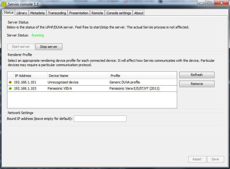

what profile do you have selected for this device under the status tab of your console?
Renik
Joined: Mon Jan 21, 2013 11:59 pm
Post Tue Jan 22, 2013 7:12 am
Re: Problems with audio on Panasonic TXL37ET5E
Here you are
