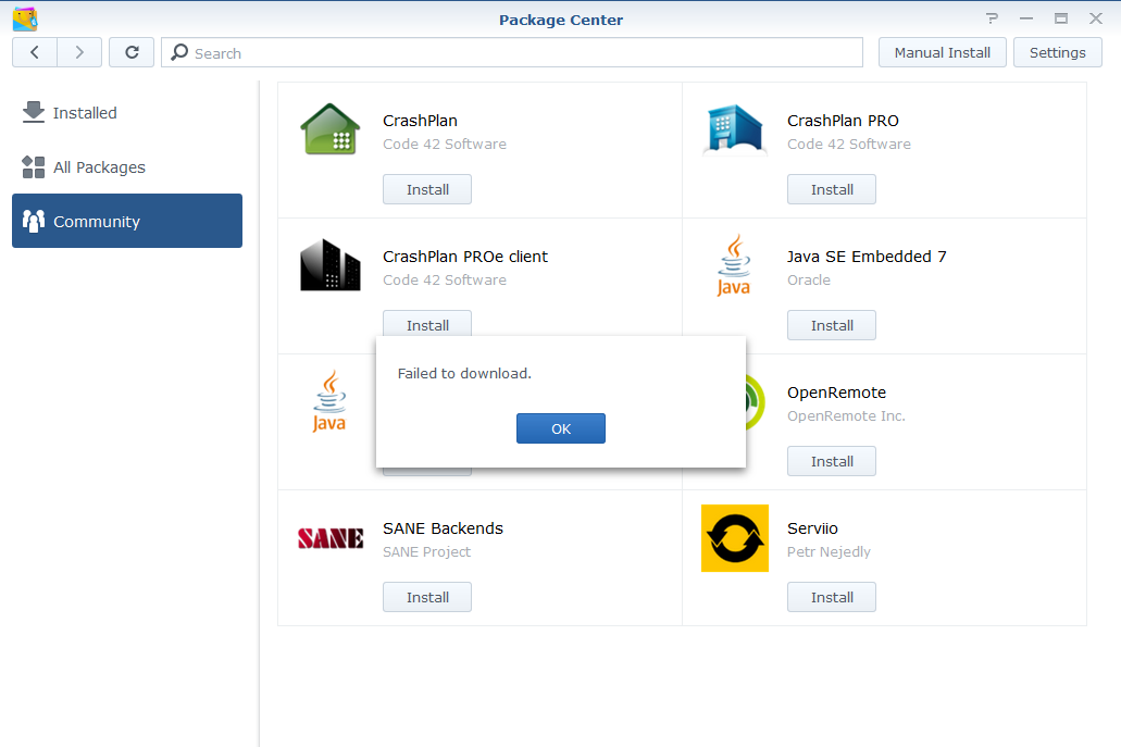

Unfortunately I just get an error "Failed to download"
Alaska99
Posts: 20
Joined: Tue May 15, 2012 2:00 am
Location: Québec
Post Wed Aug 22, 2018 10:31 pm
Re: Serviio on Synology STOPPED since last DSM Update
Same error here .

patters
Posts: 1282
Post Thu Aug 23, 2018 12:47 am
Apologies - typo in the repo package database, fixed now.
thatfellow
Posts: 10
Joined: Sat Mar 23, 2013 11:51 am
Post Thu Aug 23, 2018 8:02 pm
@patters
Great work, Java 181 installed and is running, Serviio installed but took a long time before I could open the console webpage, probably 2-3 minutes after the installation finished but It seems to be up and running now.
Thank you for your time and effort. Serviio + Diskstation are made for each other, keep up the good work. Much appreciated..
