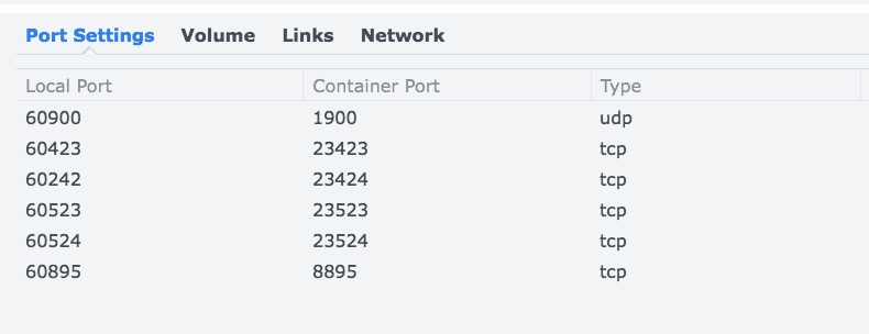

I'm running Serviio 2.3 in Docker on a Synology Nas DSM 7.1 try to connect to a Pioneer N50A and Sony Braiva TV
I ran Serviio 2.0 on DSM 6.3 very successfully in the past onto the same Pioneer N50A
Using the soerentsch/serviio docker pakage my setup is
Screen Shot 2022-12-26 at 11.04.27.jpeg (66.74 KiB) Viewed 36948 times

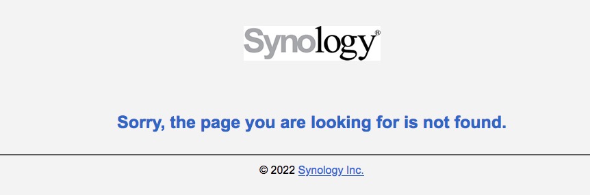

Going to myip:60423/console/#/app/welcome shows the console as normal, it reading the shared folders library no problem, but I can't get to the mediabrowser of Serviio not does it show up on my Pioneer N50A or Sony TV
When going to myip::6201/mediabrowser

Hi @Acetone,
regarding your port mapping table:
- Port 1900/udp MUST be mapp to 1900/udp. This port is specified by the UPnP protocols. Otherwise your DLNA Clients can't find your Serviio Server.
- Port 8895/tcp MUST be mapp to 8895/tcp. This port ist currently hardcoded by Serviio to deploy the media.
Regards and still a happy new year,
Soeren

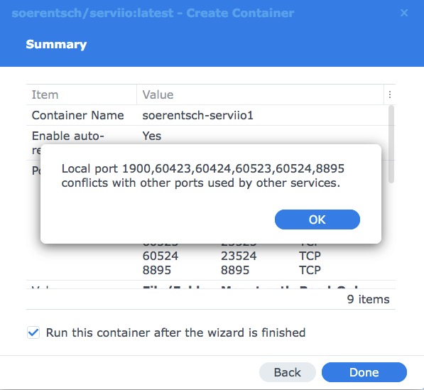

Acetone
Posts: 29
Joined: Tue May 15, 2018 8:03 am
Post Sat Jan 14, 2023 11:46 am
Re: Serviio docker
I'm now getting the following problem.
Screen Shot 2023-01-14 at 11.44.04.jpeg (98.55 KiB) Viewed 36716 times

Acetone wrote:I'm now getting the following problem.
Hello everyone. I have exactly the same problem: It took a while but I got soerentsch/serviio docker image running but the TV does not see it and if I try to change the local ports to 1900 and 8895 it sais there are other ports the syno already uses. Before setting up soerentsch/serviio docker image with DSM 7 servio 1 as explicit syno app was running for years on that syno and I uninstalled that app before updating to DSM 7 and changing to docker. Could that be some kind of old config and does anybody know how to check and delet this?
