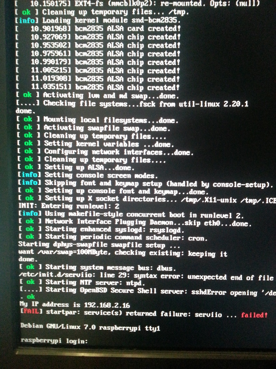

jadeskye
Joined: Sun Mar 10, 2013 3:23 pm
Post Tue Mar 12, 2013 6:06 pm
Re: Serviio on a RPi ? (Raspberry Pi)
NX3 wrote:Are you running on a model b with 256mb or 512mb ? Just out of interest....also did you compile your ffmpeg on the RPi ?
Glad someone else has tried it, not sure initially why its not working. I've not updated to 1.2 as yet but same different for the startup script. Your paths are the only think different, they are 100% correct ?
Have you checked if the service is running but not just the gui ? As that's how I left it so I use serviiodroid to control no the gui on Raspbian or test via a media device is running. From boot it can be slow if its got a lot to index, are you running from a SD, USB or HDD ? I'll update the wiki to mention it won't run the gui on my script :)
heres a picture of the log on startup
2013-03-12 18.03.58.jpg (466.54 KiB) Viewed 24902 times
NX3
Posts: 578
Post Wed Mar 13, 2013 8:19 pm
jadeskye wrote:it's a model B and i did compile FFmpeg. it took about an hour but it worked.
Only an hour !? blimey....
It works in Raspbian GUI, what I meant was Serviio is two parts. The service and the gui, my guide / script only got the service running as thats all you really need. You can run the serviio GUI as well but I saved memory by not loading it as for my setup it was not needed.
On your screenshot it says you have an error in your startup script in line 29 and you have an EOF error. Thats could be what you need to check out.

I got it working! You're missing a 'esac' on the end of the script. you should update your wiki page to reflect that and as far as i can tell, your method is ingenius and foolproof. Thanks a bunch for figuring it out!
