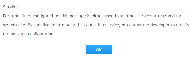

Joined: Sat Aug 26, 2017 9:14 pm
Post Sun Aug 27, 2017 6:51 pm
Re: PACKAGE: Serviio 1.9 - Synology NAS, with HW transcoding
I am installing and having the same problem you indicated with the most current serviio package for my synology nas. I can not locate the file /usr/local/etc/services.d/Serviio.sc in the zipped package, so where would I find this file remove so I can install the product? In a previous post where users received the message I did there was an indication by one person to remove the file rm /usr/local/etc/services.d/Serviio.sc but I am not sure where this file exists, in the install package of which I do not have access. Any help would be helpful.
install message for synology.JPG (24.85 KiB) Viewed 74588 times
patters
Posts: 1282
Post Mon Sep 04, 2017 10:13 pm
You can only access this location by connecting to the NAS via SSH. You need to enable SSH access in the Terminal & SNMP entry in the DSM Control Panel. You connect using an SSH client (PuTTY on Windows, Terminal on Mac) as the 'admin' user, and use the admin password. Then use:

Cannot install 1.9 on Synology 1812+ with DCM6.1.4
I am new to Serviio and I cannot install 1.9 on Synology 1812+. The NAS is running DCM 6.1.4-15217 Update 5. When I am adding http://pcloadletter.co.uk package source to the 1812 it says invalid location but on the second click it accepts the location. Problem is that I still cannot see Serviio in the packages to install.
