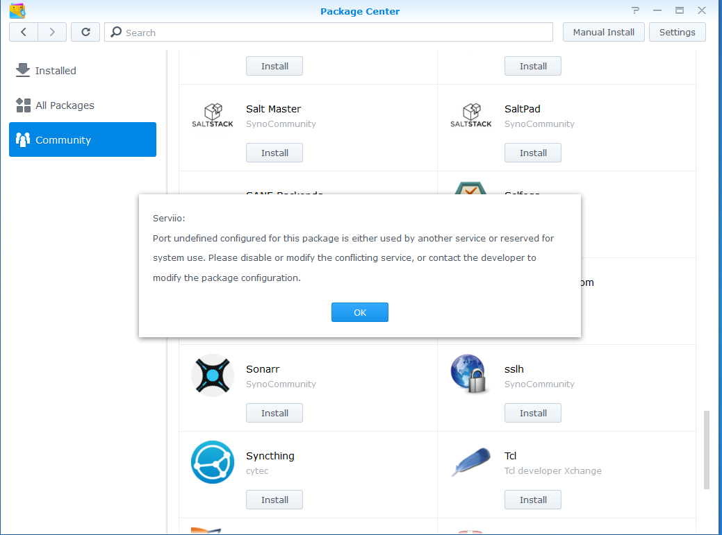

patters
Posts: 1282
Post Mon Sep 10, 2018 12:03 pm
Re: PACKAGE: Serviio 1.9.2 - Synology NAS, with HW transcodi
Have a read here:
viewtopic.php?f=14&t=19275
There's a DSM bug where sometimes during package removal, DSM leaves the firewall rules behind which will then cause the error in your screenshot when you try to re-install.
The only way to delete this file will be to enable SSH and connect in using an SSH client (PuTTY on Windows). You need to log in as the admin user. Once logged in as admin, run
sudo -i
Re-enter the admin password a second time. You're now root, be very careful to type things correctly as a mistake here could do damage.
rm /usr/local/etc/services.d/Serviio.sc
exit
exit
