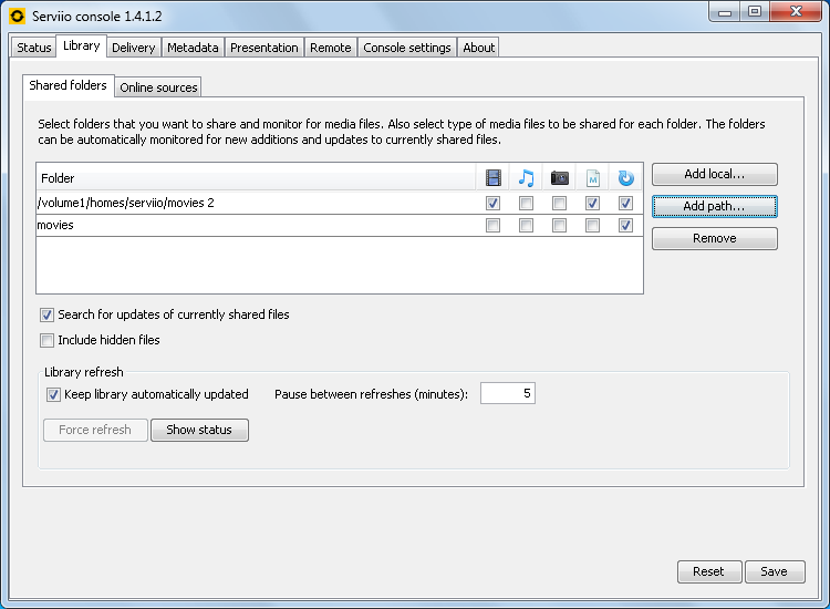

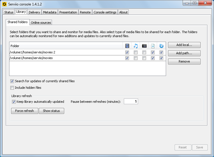

Serviio console on my Win 7 laptop would not let me enter linux pathways..ie:- /
I found a reference to adding and saving "-Dserviio.remoteHost= ( your server ip address)" in the Servioconsole.exe VMOTIONS file in the Servio Bin folder in Program files\serviio folder.
Having done this, I can now enter a Linux path in the shared folders add path location in Serviio console, and also SOLVES my problem of file source for the Diskstation Serviio folders showing in my BD tv display.....B****y hooray! :D
Unfortunately, by default this also adds "/volume1/homes/servio" to any path that I enter.
So currently I have had to add my movie folder to the Serviio folder, ( not what i want to do)
Do any of you fine chaps have any suggestions to change this default file path?
I've attached a couple of screen grabs to show the path change, the first one shows the file name entered before saving it..shown in grab 2...
This has taken up far too much of my life!!...... Sadly for me? I know nothing about any form of coding ..... Its just in my nature to make things work!! :lol: Cheers! Ken

Synology DSM hides the real filesystem path from you in the GUI. So let's say for example you have a top level shared folder in DSM called "Movies", you would need to enter it as "/volume1/Movies" into the Serviio Console. Since it's Linux remember that it's case sensitive too.
Now remember that you're using the Console to edit settings on your NAS's Serviio instance, and telling it where the files are on the NAS. Don't try to prefix it with an IP address - it's not needed. You will get this "/volume1/homes/serviio" substitution happening if you fail to prefix your path with a slash (which all Linux paths have since slash is the root folder). See this thread:
viewtopic.php?f=14&t=8600&p=59876&hilit=%2Fvolume1%2Fhomes%2Fserviio#p59876
Remember to make sure that the serviio user has read access to that shared folder
Control Panel > File Sharing > Shared Folder > (select shared folder) > Edit > Permissions tab
P.S. I hope you get it working. You've done all the hard parts!
