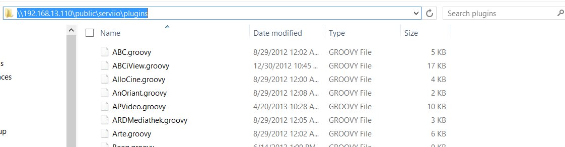

So I have a very similar problem. I'm running DSM 5.0-4493 Update 2 on my 1511+. All my folders work fine except the online content. As per the screenshot below, I think I have the .groovy files in the correct folder. Is there something I'm missing?

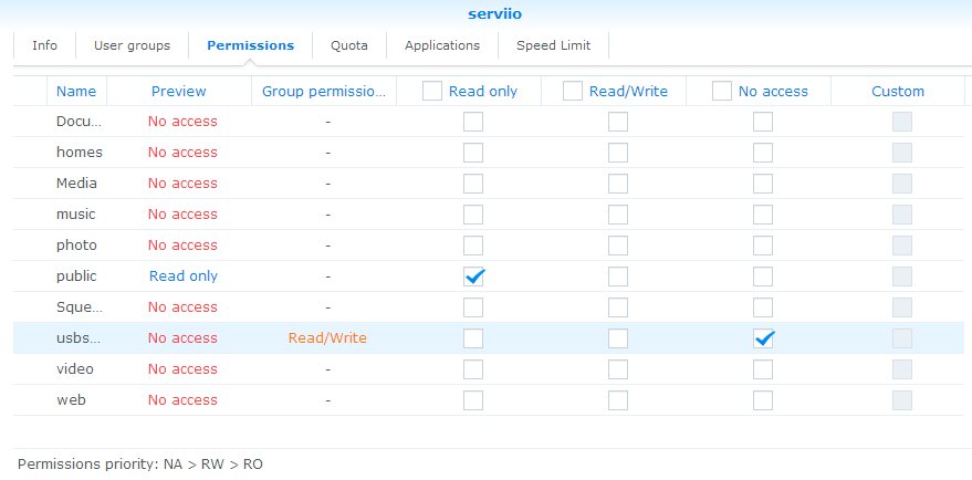

Does the serviio user definitely have permission to read the 'public' shared folder?

4 - Folder permissions : controlpanel - user - hit "Serviio" - Edit - Permissions - mark "public" on read/write - OK
