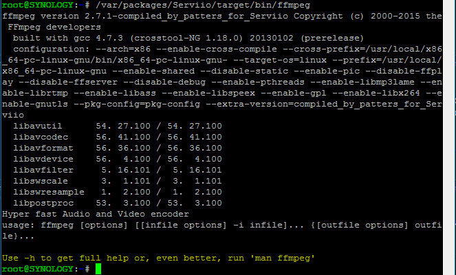

Can you also connect via SSH and run:
sudo -i
(put in your admin password, now you're running as root)
/var/packages/Serviio/target/bin/ffmpeg
Does that work?

P.S. I'll add another directory with many files ~ 4000 and then do what you asked for: connect with SSH, "sudo -i; /var/packages/Serviio/target/bin/ffmpeg;"

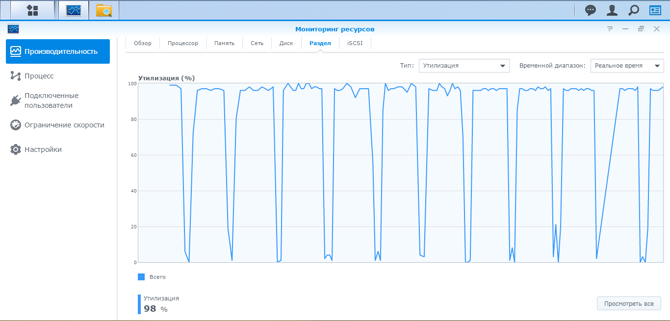

The fact that a single application loads NAS to 100% for some hours, is alredy a problem. Adding files to the database and scanning media files really slow.
After Serviio added all the files to the database, it continues to work like this (the size of the graph exactly 1 hour):
